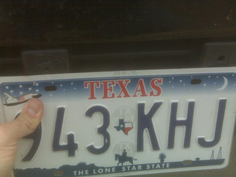

Hey everyone,
Newbie here to the 4Runner world, and for the life of me, I can't figure out what's going on with my front license plate mounts. From looking at a couple different state license plates, it appears that they all follow the same pattern for hole placement (seems like common sense so every state would fit every vehicle). However, as you can see in the photos, my plate holes don't match the holes in the mount on the front bumper...any idea why this is, or how it can be remedied?
Sorry...forgot to include the image.

I had the same issue, but the dealer just used two screws, centered the plate, and tapped right into the same area and screwed it in.

I also had the same issue...If you look to the inside of the factory holes, you should see two concave nipples. These, you will find, line up perfectly with the outside of your license holes. You will have to use two self tapping screws to mount that plate. If you don't want to mess up the factory look, you could use zip ties to line it up centered but It wont be very sturdy at the bottom...

Thanks! I'm just curious what the original holes are for...
My dealer didn't know what the factory holes are for either. My dealer told me to do what matroe11 did...use the two dimples and pop the screws in there.

Probably European/Asian plates.
