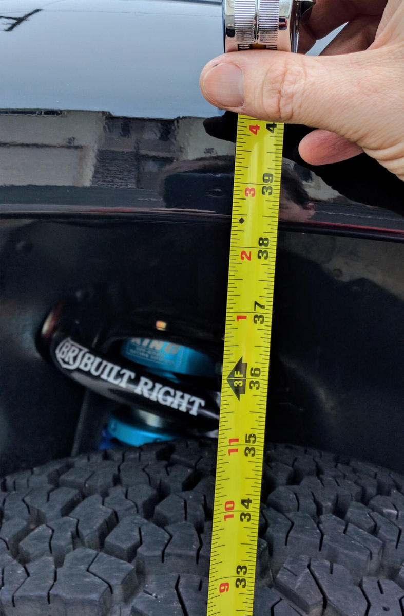

Too high?
I'm at about 2" lift with 1" BL and 285x75x16 (32.8") tires, King front end resulting in around 29.5" distance from ground to fender, center of tire.
My CV are fine. I don't think you have too worry about too much lift but I wouldn't go higher.

Too high?
My CV are fine. I don't think you have too worry about too much lift. You should *always* use a diff drop when lifting these trucks. It is easy and cheap.
For the kit the OP has installed it's high. Apples to apples not apples to oranges. lol As far as the diff drop goes, that's your opinion and your entitled to it. I don't agree that they are needed so I didn't install mine. If I bind and break a shaft that's my problem but it hasn't happened yet.
