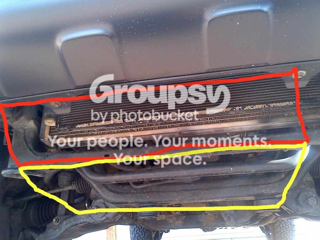

I don't have the stock skid plate and cant seem to find an upgrade. I went through the body armor thread and seems those skid plates start after the stock one ends?
Im not doing any rock crawlering so just would like to improve upon the oem one.

I guess I need to clarify what I'm looking for.
I think I'm missing a skid plate that covers the red area and most of the skids that I see for sale start at the yellow and go back.
Do I have that right?
As far as I know , the skids didn't start til the yellow area. They start at the yellow area and go back. Toyota made a thin silver one that went at the red area , but it was completely for looks and didn't serve much protective purpose.
The 4th Gen does not have a skid plate for the red area shown.
The one offered by Toyota is more of a cosmetic accessory than a skid plate.
I have one of these to protect from stones, branches etc. I do not consider it as a "skid plate" for sliding over rocks.
