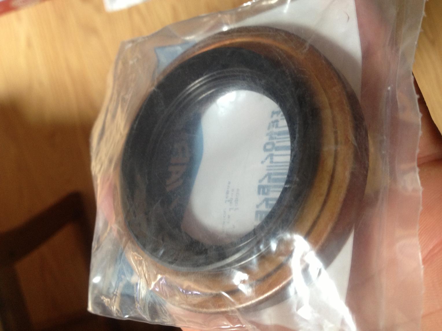

I went to Toyota and they didn't have it, so I stopped at the local auto parts store and after arguing with the damn lady behind the counter (she had no ****n idea what I was talking about), in the end I came home with this. Can someone please tell me I bought the right one? Lol
I looked it up online 052-3749 beck/arnley and it said diff seal so I'm hoping it is. Last thing I want is my runner down and wrong part

that looks about right if i can remember. I know the drivers and passenger side are different size. Its a super easy seal to change.
Sweeeet deal. Thanks j-money!
After class I'll go and get this done then. So from research my plan of action is to pull the old seal with a screwdriver, place the new seal and gently tap it in with an extension and mallet, and tap it in till the seal is flush with the diff, then install the cv shaft.

Easy to yank out the seal, PITA to place the new one since its a friction type of seal. But all is good right now, thanks again guys!
