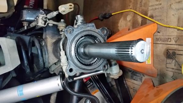

I didn't try to regain ABS for years after I installed the kit. In the case of my SR5, automatic transmission, 3.4L V6, came with ABS, the rear wheel speed sensors are on the rear axle next to the "inner" seal for the axle. Note that I know someone that had a 4 cylinder base model of 3rd gen 4Runner with manual transmission. The speed sensor for their speedometer was at the transmission. So that may vary for some people.
I did have an annoying issue with the speedometer for years. Every time after starting the engine, the speedometer wouldn't budge until after I moved and then stopped at least once, and then got above 30 mph. Then the speedo would ignore the lack of signal from the rear axle and operate normally from the front wheel speed sensors. Otherwise, the speedo just sat at zero. This was an issue in times such as when I briefly stopped on the side of a highway, restarted the engine, and forgot to stop at least once after moving a bit. The speedo would just sit at 0 while I'm driving down the highway until I stop and start moving again. That was just annoying. That was only fixed by my custom installing the wheel speed sensors on the rear axles again.
I agree that the ABS functionality by Toyota on the 2000 4Runner is relatively poor because when it notices a wheel start to lock up, it just pulsed the ABS for a set amount of time regardless of whether all 4 tires are on concrete and you just drove over an expansion joint. That's dumb. It's not actually looking real-time at what's going on with the wheel speed sensors during that time.

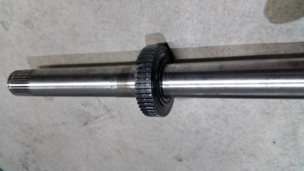

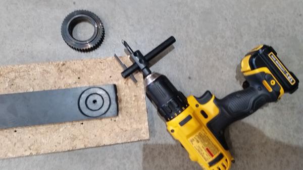

Due to the diameter of the new rear axle, the wheel speed sensor has nothing to mount onto. The wheel speed sensor's inner diameter is actually larger than the axle, so you only need to fill that gap. After I debated about different ways to do this, I eventually chose a 0.5" thick chunk of Viton rubber, which I specifically chose due to its resistance to deteriorating with synthetic gear lube. I used a hole saw to cut out a ring of rubber that fits very tight between the wheel speed sensor and the axle. It took multiple attempts for me to get the dimensions right. And it still took a long time for me to cram it on there, but it's so tight that it's going anywhere. I lined them up with the sensors and it works. This falls in the category of a custom solution that isn't realistic for FROR to offer as a public solution for regaining ABS. A disadvantage is I can't just pull the rear axle out through the center of the hub anymore, but that axle is so strong that I seriously doubt the axle would ever break on my vehicle. So I'm not bothered by the fact that I have to remove the 4 nuts that hold the entire "chunk" against the axle tube before I can remove the axle shafts, for whatever reason.
