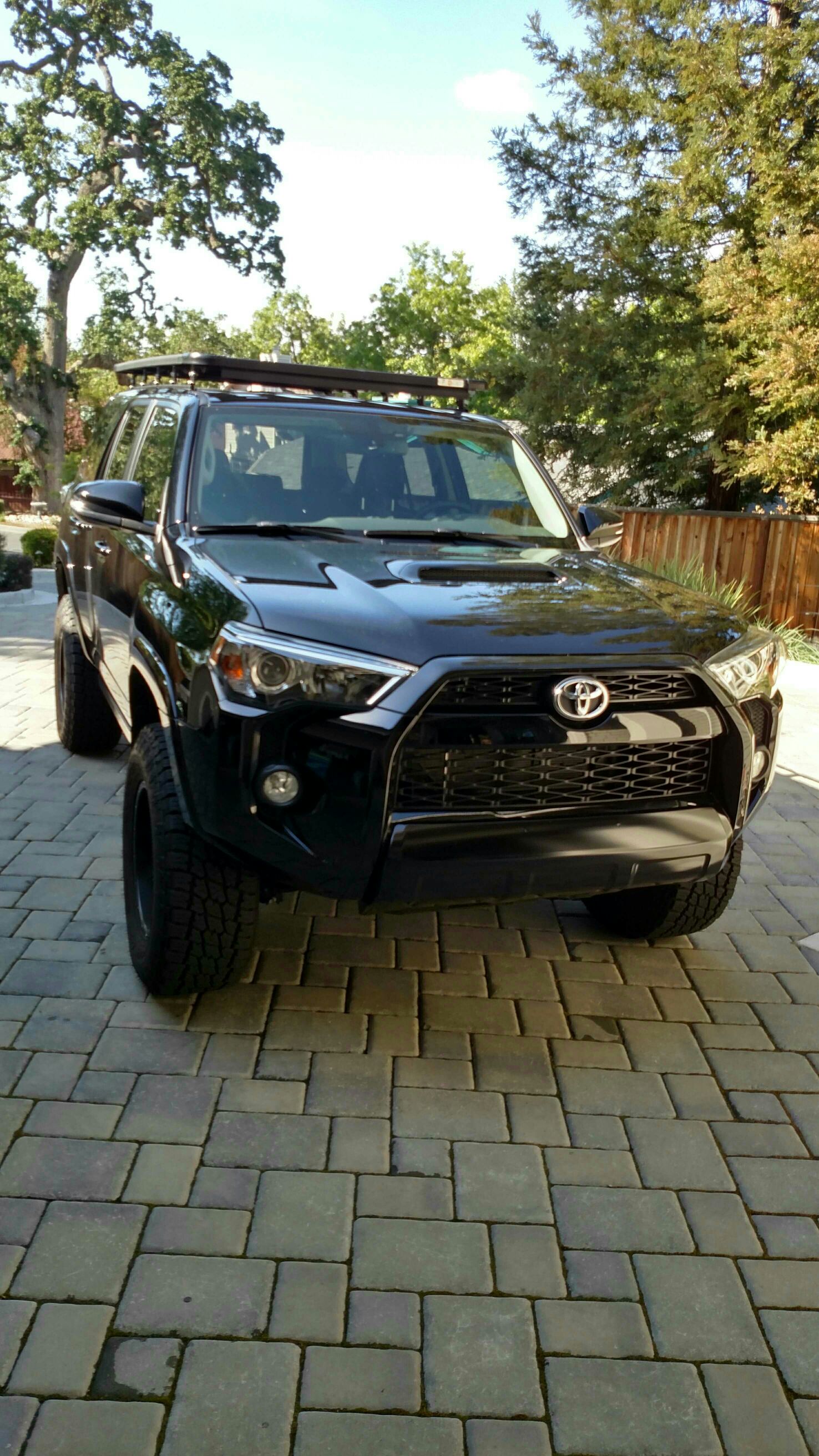

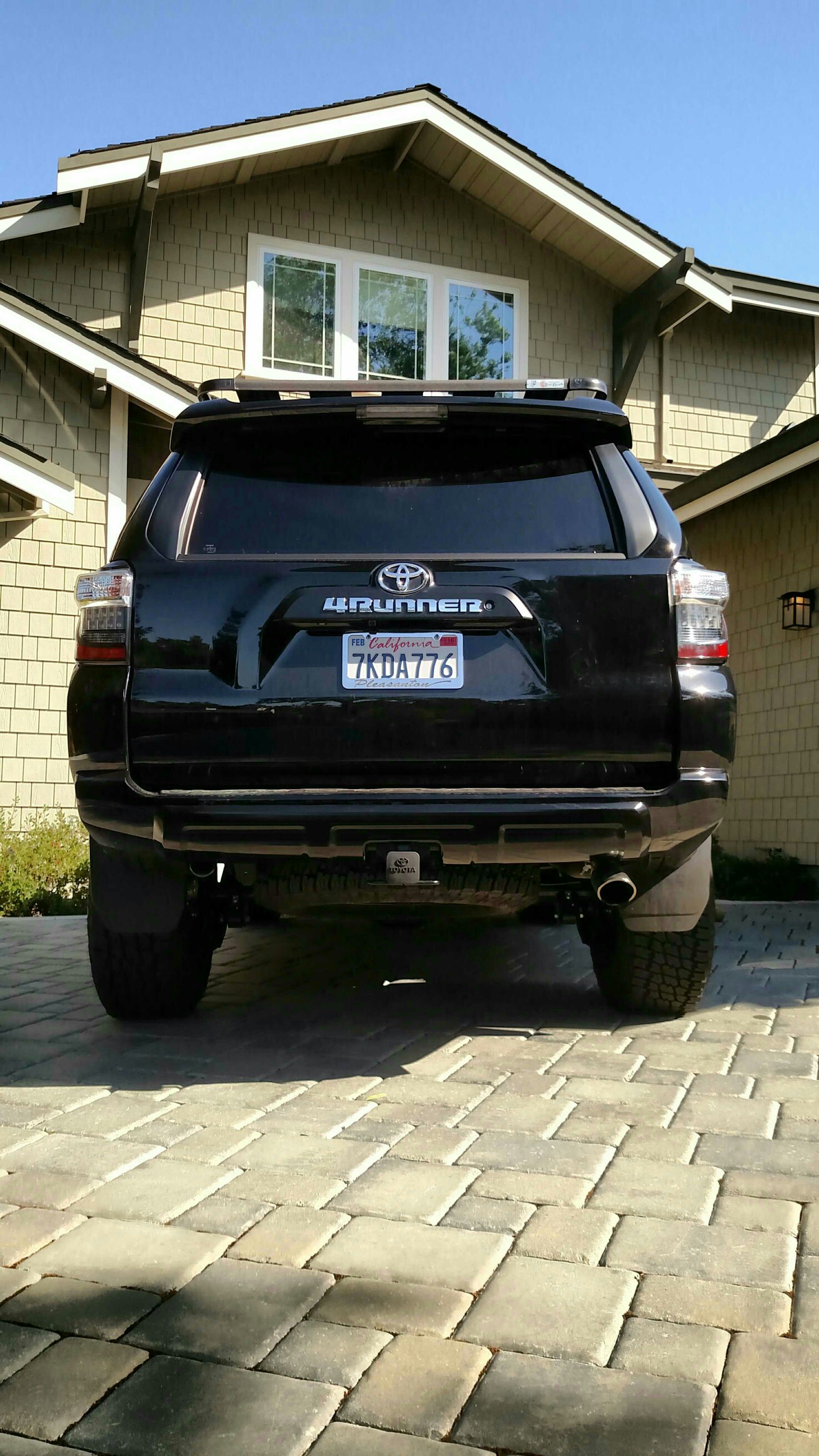

Installed. I took both front and rear covers off after trying to reach in to get to the clips. It was not hard or complicated. Removal was pretty obvious and I only needed help while removing the wires from the fogs.
I think it looks great and well worth the money and a couple hours work.

They are kind of a semi-gloss black and do not exactly match the Attitude Black paint. Still looks great tho...
