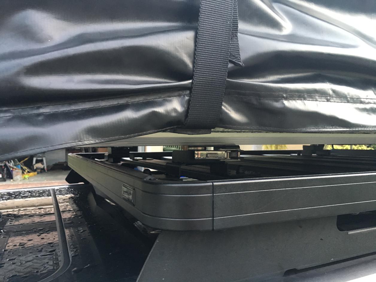

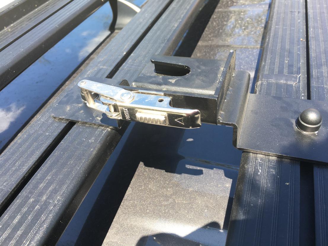

Here are a couple of pics of the FR rack and RTT with the FR quick release mounts.
Pros: The quick release is really easy to install and works perfectly. It seriously takes 2 mins to take RTT off the rack.
Cons: The RTT sits up about 5-6, inches higher than before which causes more wind noise. It cost a lot $300. Center of gravity of the vehicle is higher.
Overall, I'm happy with it. It's worth it for me. It won't be a PITA to take off and on.

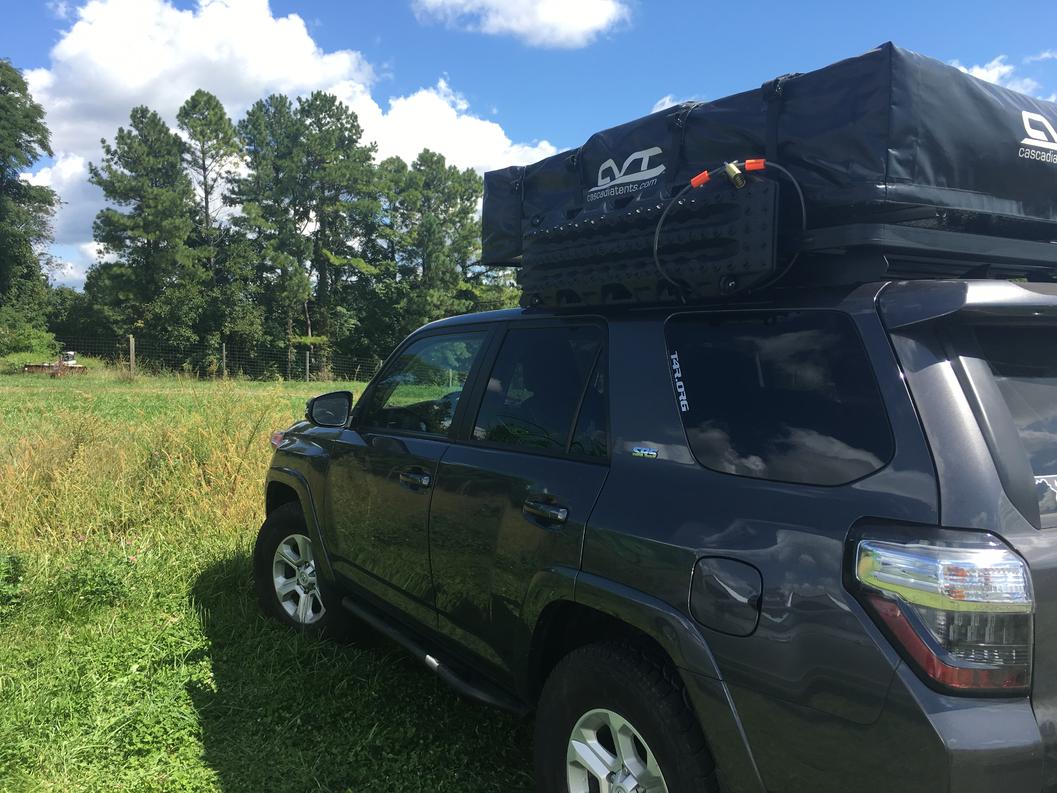

These are so worth the $. After all initial install and measurements it takes less than 5 minutes to take CVT Mt. rainier Summit Series on and off. They are also lockable rig a TSA Style cable lock. Insert into pinhole and it's virtually impossible to get at with anything other than the key to the lock.
Hey! Looks good. Can you explain how the quick release mounts make it sit over 5 inches taller? It doesn't look like it would be more than a couple inches taller than sitting directly on the Front Runner.
Thanks!
