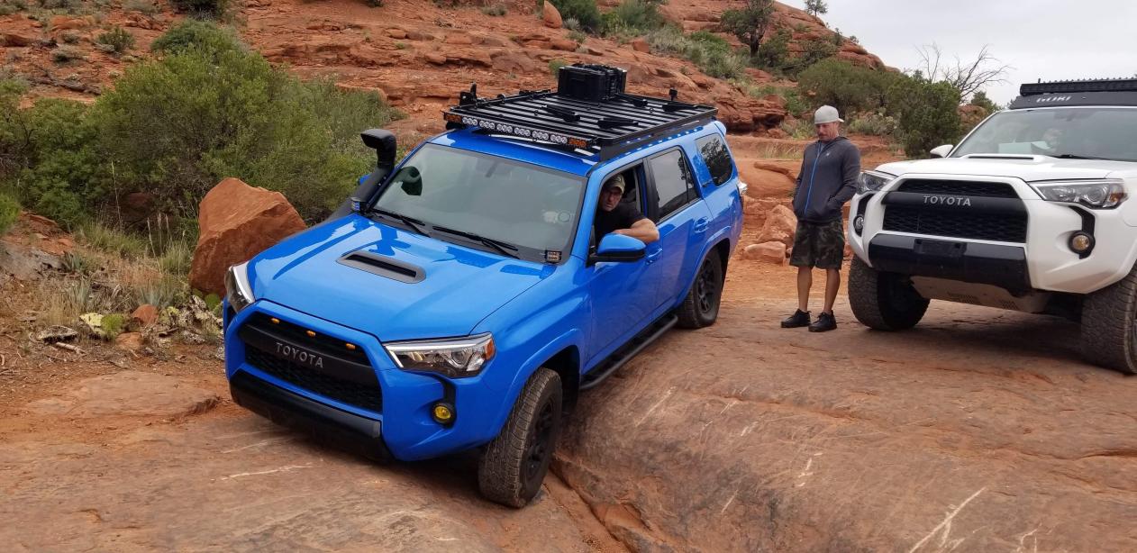

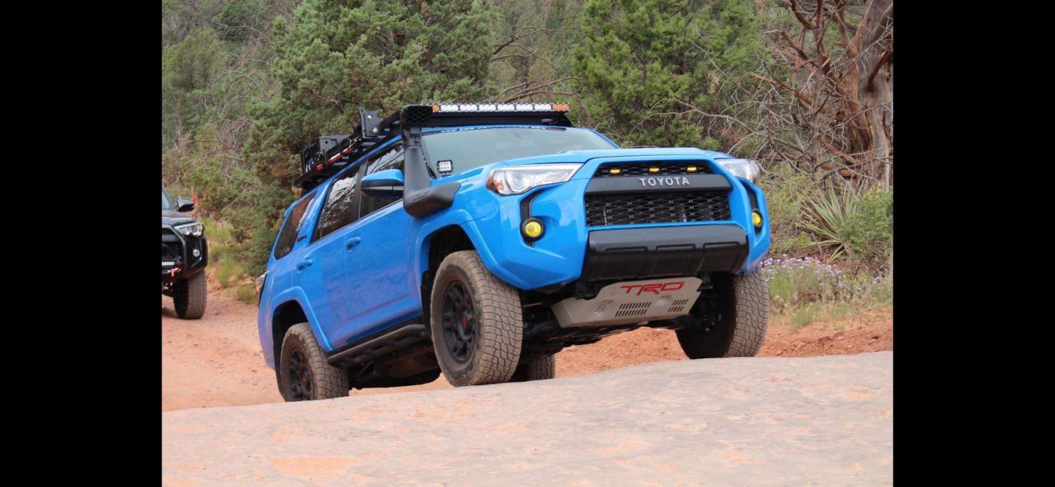

I got the idea of mounting a bar under the rack by looking at SixthSnail's set up
https://www.toyota-4runner.org/5th-gen-t4rs/219422-sixthsnails-sr5-premium-build.html
I messaged him, but looks like he has not been on in quite sometime.

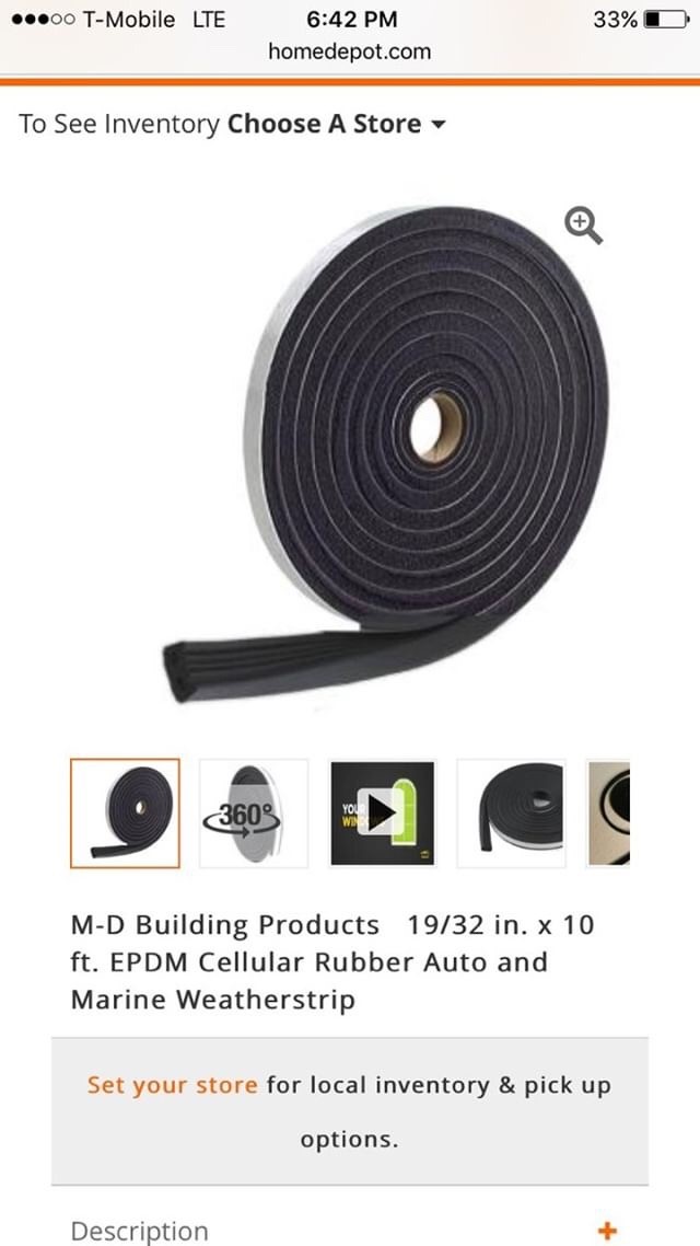

I had a flat t slotted rack similar to the front runner and mounted a 40" bar underneath. There will be a gap between the rack and the light bar but just use some weather stripping stuff to close that gap to get rid of the whistling. This is what i used
