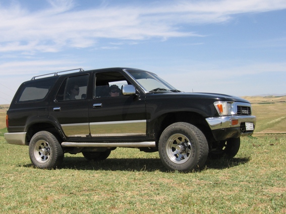

Hi,
I am still new to the Runners and I can't figure out the 4x4 system on my 1990 4Runner (5 manual).
So, when it is in rear wheel drive, the front diff is disengaged and the shaft spin or not? Also if I spint one of the front wheels (when lifted off the ground) is the shaft supposed to spin? Does that mean the diff spins too?
Or does this mean my hubs are gone or something else?...
Please help.
