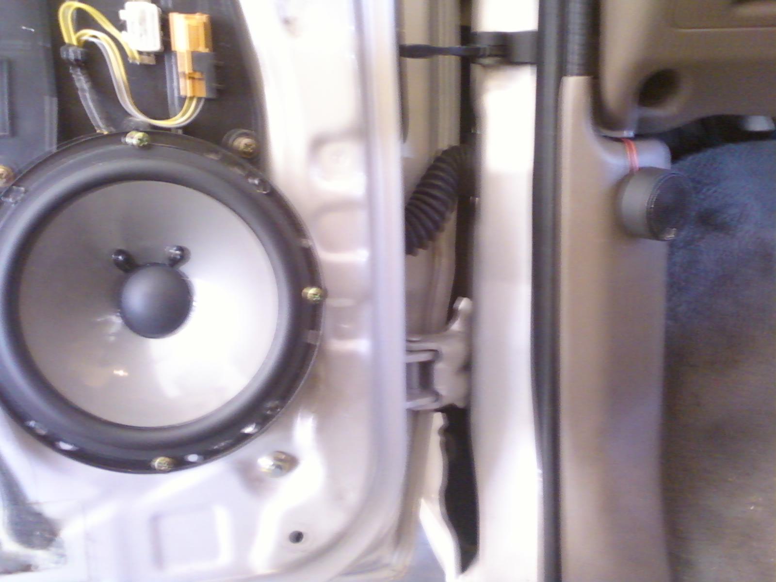

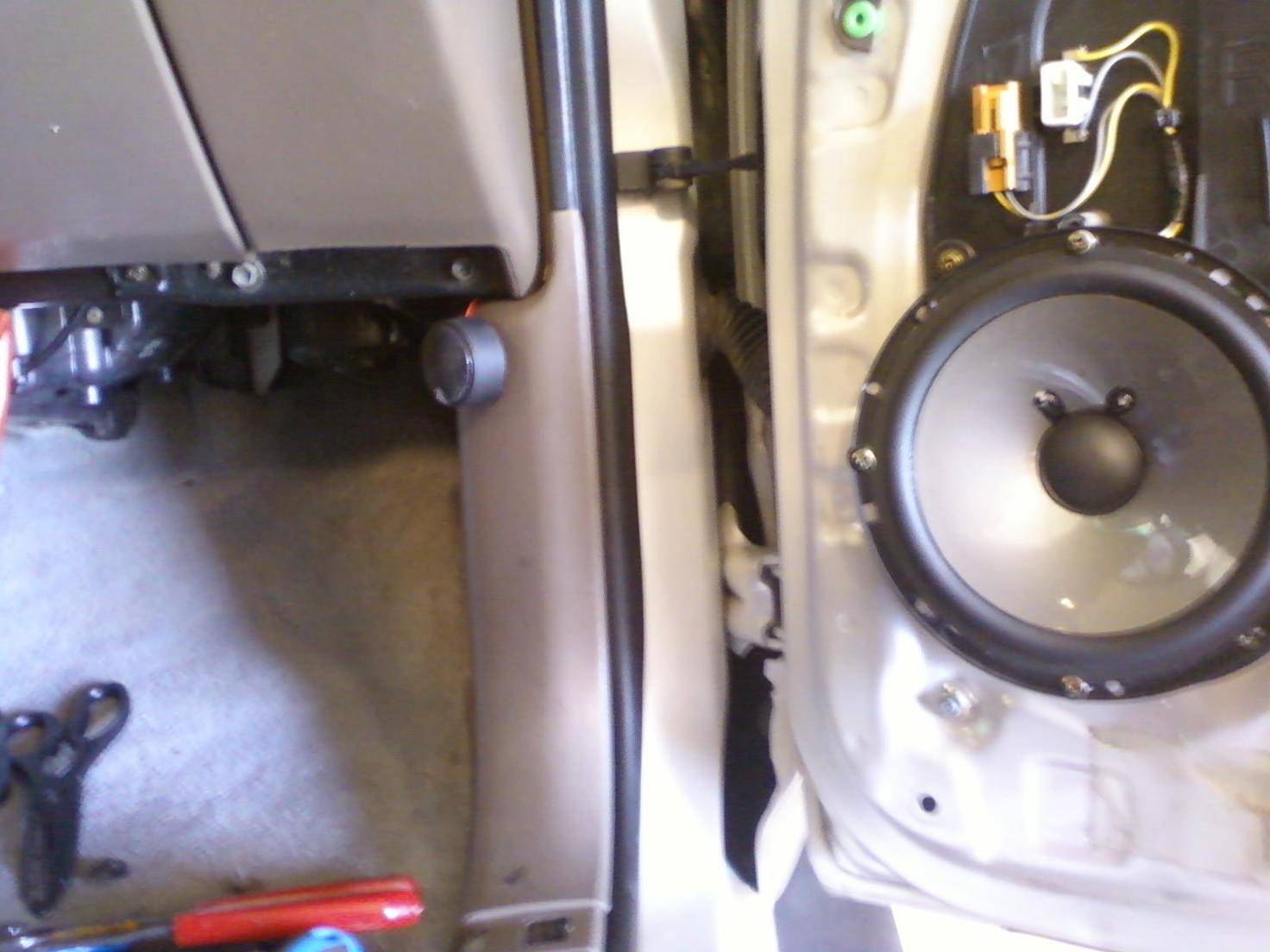

Ive got JL Audio C2 650-Cs in the front doors of my 98. the 6.5 mid is in the same plastic baffle from the factory, I just had to tilt the speaker mounting screws a little. My C2 650 Cs are running off my JL Audio black edition slash 300/4v1
Do you listen to a lot of music while lying on the floor? Why are your tweeters on the kick panel? Tweeters are very directional, unlike woofers. You'll get a way better sounding system if they're mounted on the sail panel of the doors or on the A-pillars.
Unless you like good imaging. You are right, the higher frequencies are much easier to determine the origin of, which is why if they sit in the kick panel and are cross aimed the won't pull the image to the side like the stock location does. The door location is just too close to your ear and will almost always pull the sound to the side of the vehicle that your on.

stock tweeters in the mirror cover (aka sail panel, my SR5 has the stock tweets their) running on head unit power is fine in that location. with an actual component set (mids, tweets and crossovers) that are amped, having tweets in the mirror cover take away from the imaging and overall dynamics of the sound. down in the kick panels keeps the imaging clear. my last car I had MB Quart components, mid in the door and tweet in the a-pillar it sounded pretty good but the tweets being that high brought too much attention to the highs and the mids werent as noticeagble (clear) in my 4runner, with where the mids and tweets are located, the front staging and imaging is 10 times better than in my last car. I do know that different speakers can effect that too but, I am using the same amp from the previous car with the same gain setting and same frequencies. My wife (who doesnt like stereos) has even commented that my install sounds alot better in my 4runner than it did in my last car. For what its worth, JL Audio even says that kick panels or in the door by the mid is the optimum tweet location
