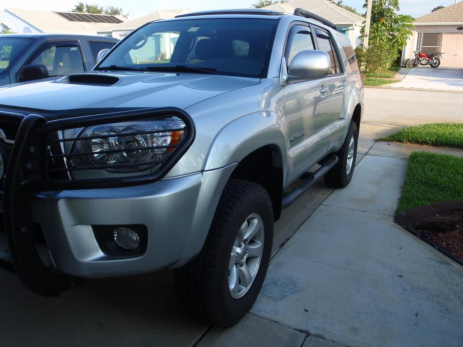

I just replaced my X-Reas with the Toytec Ultimate lift and don't regret it one bit. The lift cost me just under 1300 shipping included. It took me 7 hour to do the lift by myself. So it wasn't that bad. here is a picture of the lift.
If you look around you can get SAW for not much more than Toytec, and IMHO the SAW kit is higher quality than the Toytec one, especially in the area of front shocks. The SAW's seem to be much more heavy duty.
