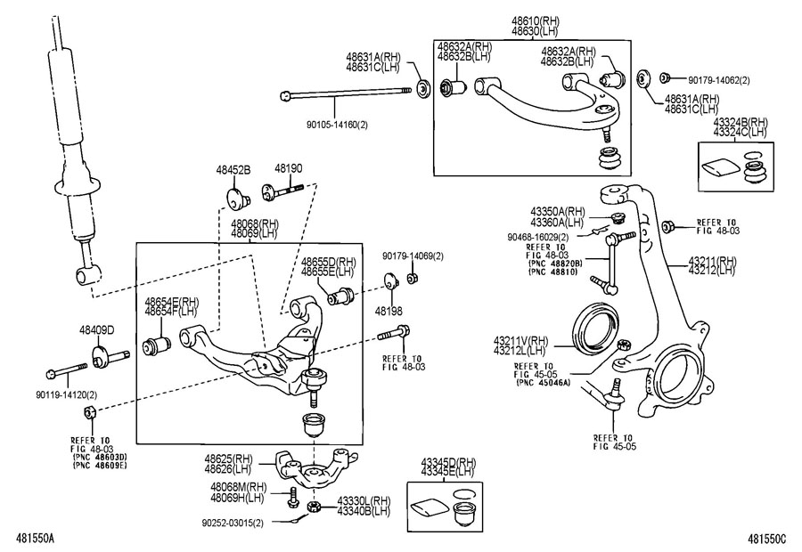

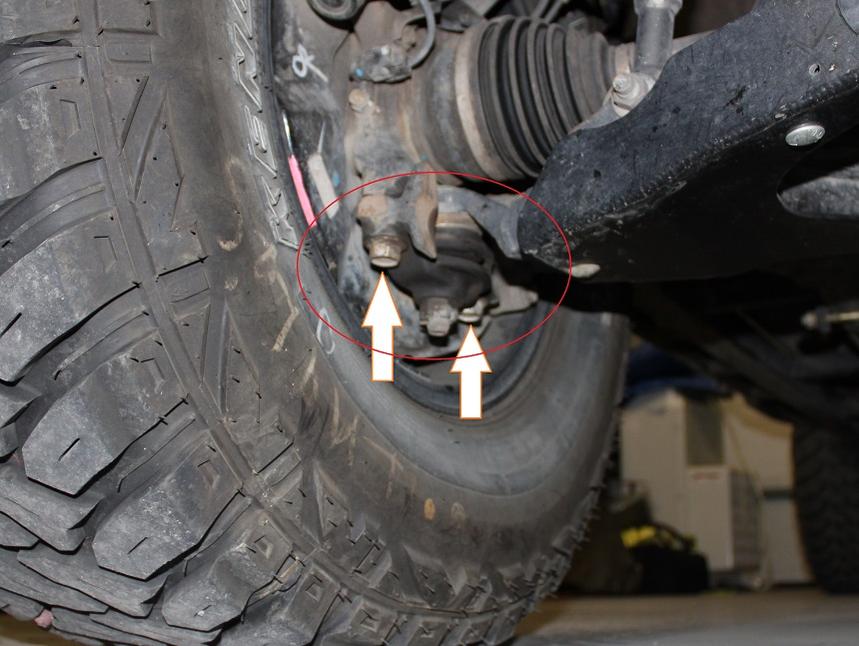

Did you pull the 2 bolts (48068M/48069H) out of the control arm bracket (48625/48626)? That helps, support the UCA and caliper with a bungee cord or something...so you don't kill the ABS wire.
I guess if you have the axle out you already did this.
You can force the LCA down with a breaker bar or some bar like device.
