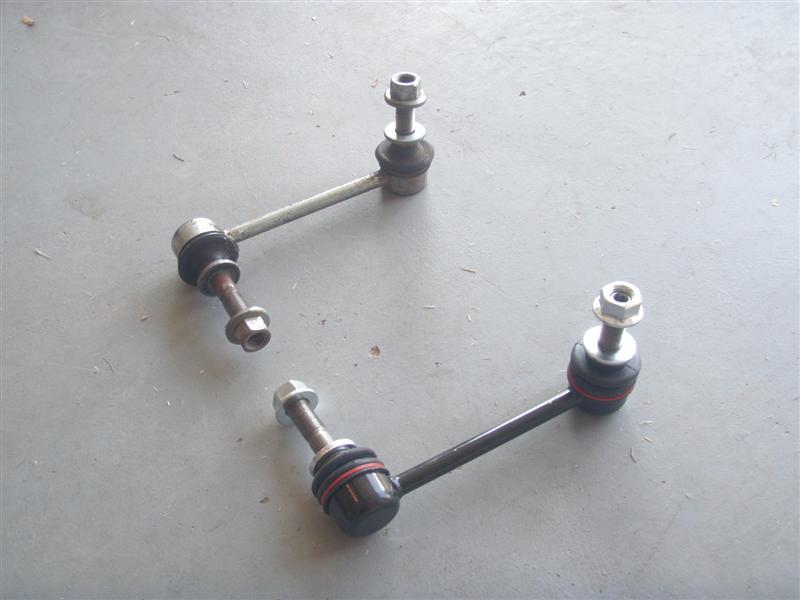

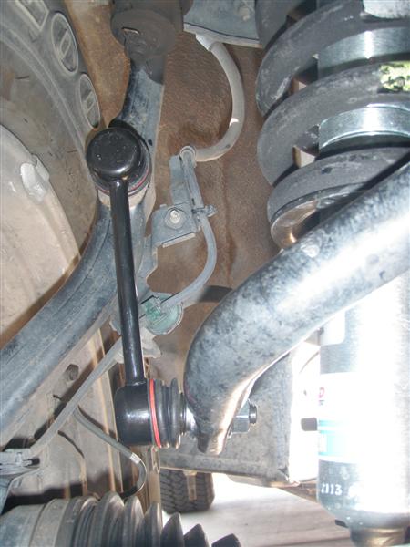

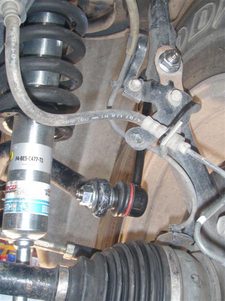

So last night while installing my new Icon coilovers, I noticed that both of my front sway bar end links were spewing grease as all of the rubber seals were cracked.
I checked with the local stealers and they want $112 per link. Ugh!
What should I do? Replace with OEM links (I think I can find them for around $70ea online), or should I replace them with ones from Allpro? Has anyone successfully repaired these using RTV silicone or something else?
I used some type rubber compound to temporarily seal the slit I had in my mine.
Ended up ordering some DEEZAs (TYL663/665) through RockAuto.com. Pretty inexpensive and easy to install. We'll see how they end up working/lasting....
