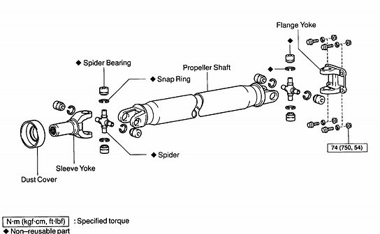

Being a 2wd it most likely be changeable.
Heres a picture to show you.
In fact I think both U-Joints are the same part.
Looking at this image, I'm sure they both are replaceable. If you don't want to do it you can take it one of the small auto parts/machine shops and have them do it or a driveline/driveshaft shop.
Pull the driveshaft out and five it a feel. Rotate and roll slowly, it should be smooth feeling.
