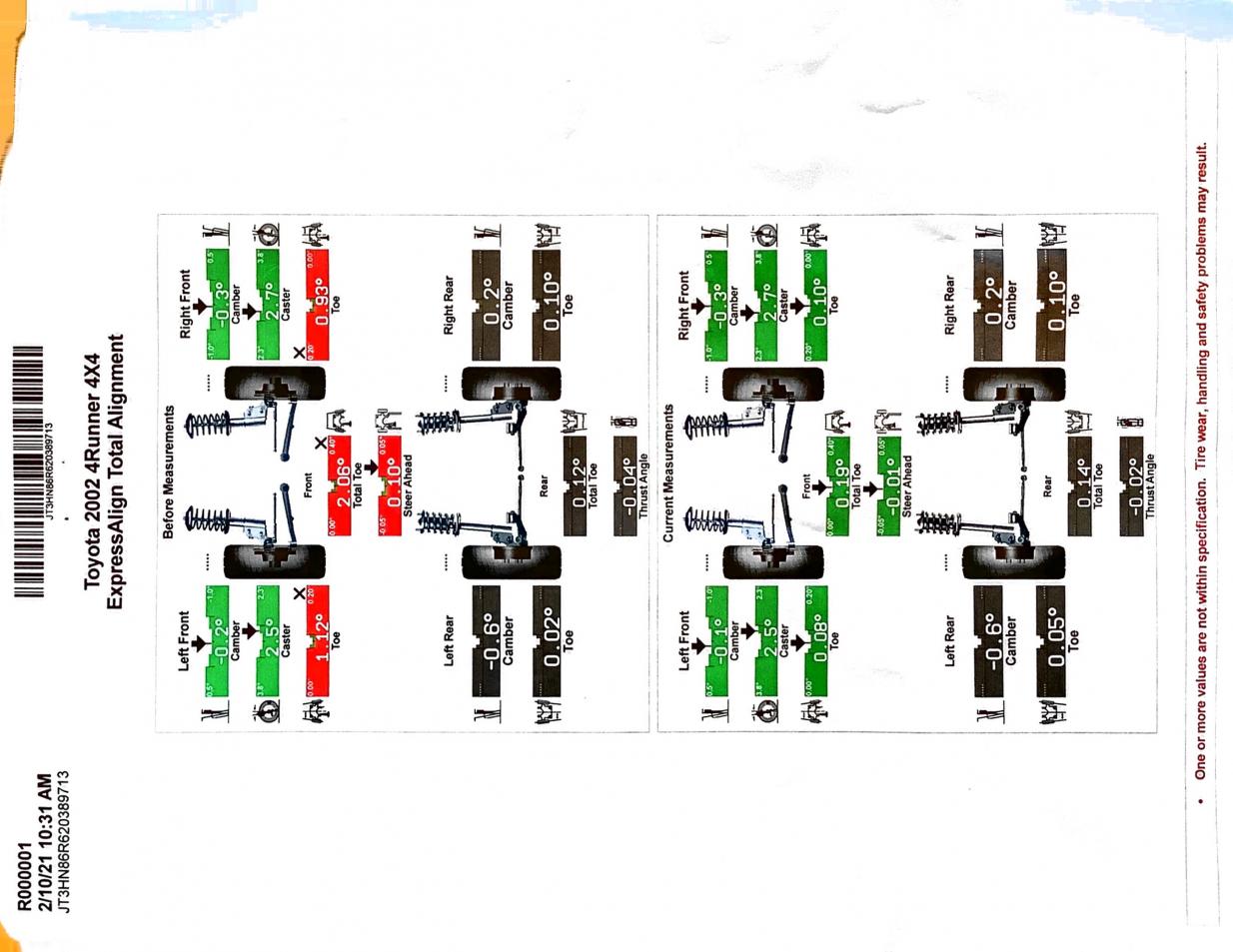

Just back from dealer after wheel alignment.
Print out below

Looks ok, they didn't attempt to adjust caster or camber as the numbers look good, and the toe on one side is at the limit of the acceptable range but ok. Curious how well they balanced out the tie-rods but you should be good to go.
I’ll have it up in the air for a look and will grab some quick measurements later this afternoon.
Based on those numbers I suspect not many threads left on the left side.
I spoke with the tech about the Caster & Camber. He said no need to make any changes other than Toe as others were good which seems to be indicated in the print out.
He said adjusting cams looked to be in good shape as well as LCA bushings.
He is correct, no need to adjust LCA cams if camber/caster is correct and tie-rod thread is balanced as per FSM. He cannot tell you the adjusters condition buy looking at it, you would have to loosen them to see if they are free which he didn't, but he should have done a full front end inspection before performing the alignment which should flag bad LCA bushings if present although difficult to inspect without loosening cams, so he is correct and you're aligned and good to go so no worries until you notice tire wear, LCA play, torn LCA bushings and or pulling L/R while braking or clucking noises, if you decide to lift it making adjustments to the LCA can is critical for alignment, but that's not a concern for you, glad it worked out as the numbers look good except toe on one side is at the outter limit of acceptable, but ok.
Those results look good. If you are going to +1 your tire size, you might need to increase caster - but with stock size tires that should drive good. The slightly higher camber and caster on the passenger side will correct for road crown a bit but not increase tire wear.
