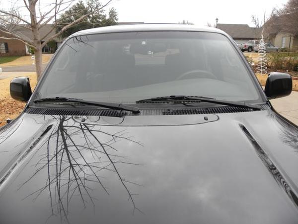

Here are pics of the messed up wipers necessitating this repair.
Down position:
Up position:
