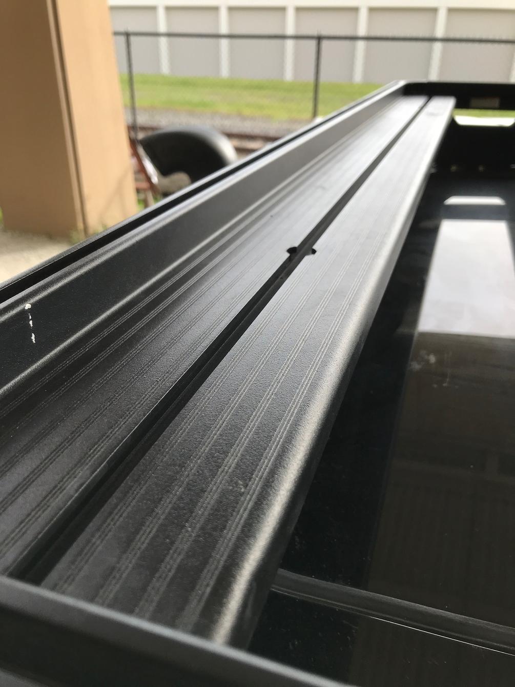

Asking for help! On my 4Runner I have a Frontrunner Slimline II full length roof rack installed, and I completed a purchase today for an Autohome Maggiolina Airland Plus, size Small. The length of the rack is not an issue, however when it comes to width, the tent is about half an inch wider than the roof rack itself. Those of you who have a frontrunner rack know that the outer perimeter of the rack have a slight lip which prevents the tent from sitting flush on the rack:

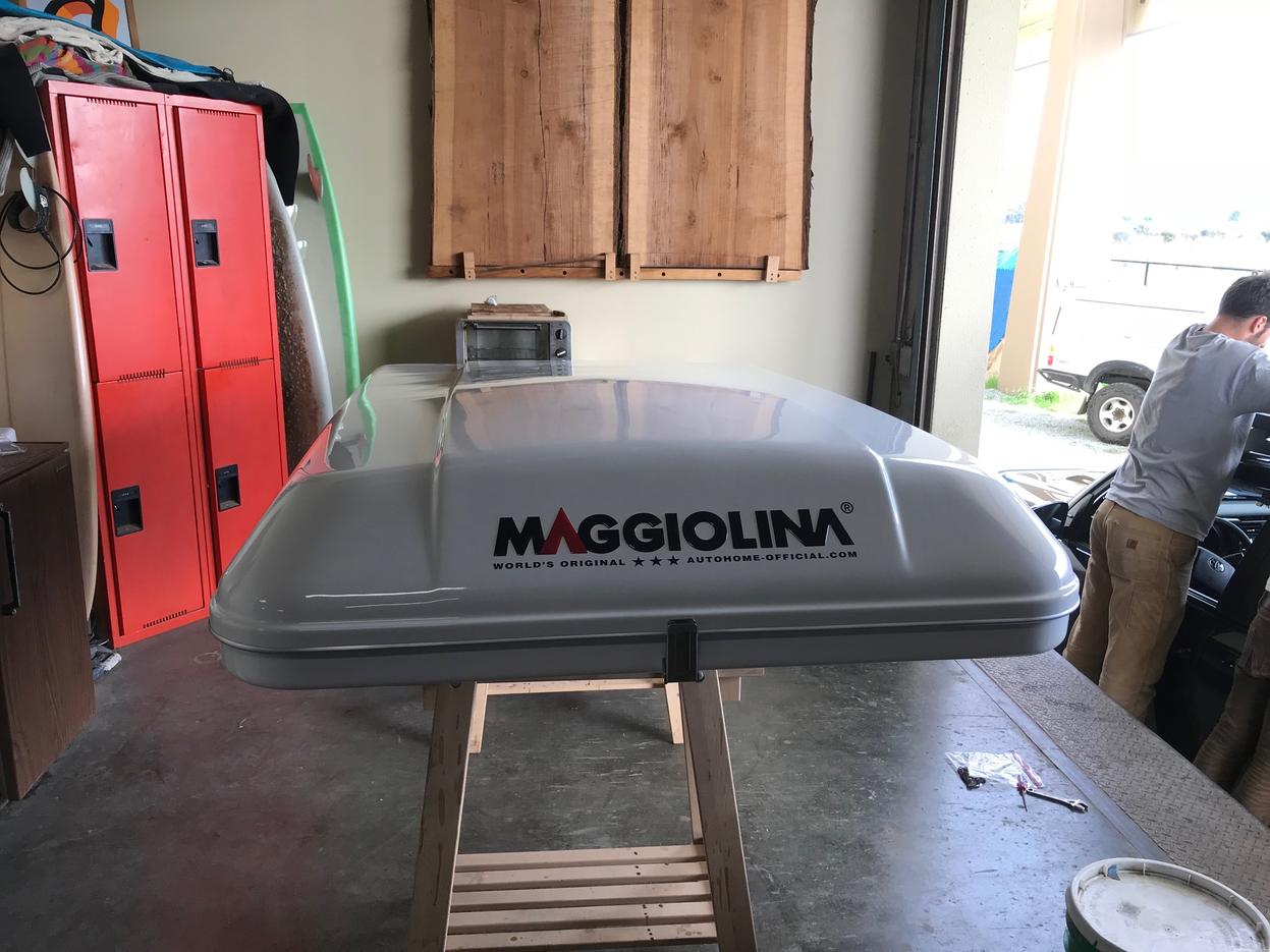

The Tent:

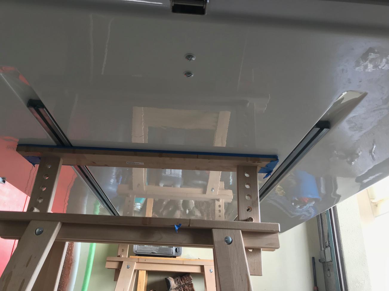

This leads into the dilemma I'm currently facing. The folks at Autohome suggested flipping the roof rack upside down (not my first choice but feasible solution), upon trying this, we found the rack will not sit flush on the roof mounts due to the "lip" being put on the bottom side of the rack. A fix to this could be to either grind down the "skate" style roof mounts to accommodate the rack. Another option would be to either custom fabricate or try and adapt new roof mounts to allow the roof rack to sit level, but upside down still. While this might work I'd rather try to work out a solution that does not require me to turn my rack upside down to mount the tent. Another solution suggested by Autohome was to ditch the outside frame of the roof rack and just run the tent with 6 cross slats - I would like to avoid deconstructing the roof rack if possible. Since I've drilled into my roof to mount the frontrunner, a new roof rack would be an absolute last resort for me.

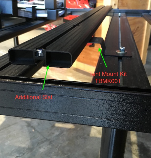

Upon further researching, I found some information on expedition portal where someone had adapted additional slats into their front runner rack to allow the mounting points for the tent to be raised. I'm currently awaiting Frontrunner to get back to me on this solution, but wanted to take the chance to get this thread out there and see what other people might have done. Has anyone done this?
The Tent:

Call Rin at OK4WD. They have a solution they made for the James Baroud tents. The Maggliolina tents use the same rail with u-bolts mounting as the JB tents. Their kit is similar to the one pictured but they use Alu-Cab cross bars mounted on their own fabricated lifting feet. It will put your tent 1/8" above the FR rack's side rim.
I had the same issue, but talking with Rin, he suggested I get the 1425mm wide FR Slimline II rack. Its not the 4runner specific one, but it comes with the same foot rails, just a wider tray. That tray is 56" wide and my JB tent is 55"!
Get some 8020 extrusions, cut some pieces to make spacers and use a piece as a cross bar for the RTT
Funny, I actually shot them an email late last night about that kit after I found some info on expedition portal. I figured a wider rack would also be an option, glad to know you were able to make it work. Thanks!
Yep, essentially just need about an extra inch of clearance to get the tent over the lip. I figure the frontrunner mounts specific to the autohome with some longer bolts should work just fine.
