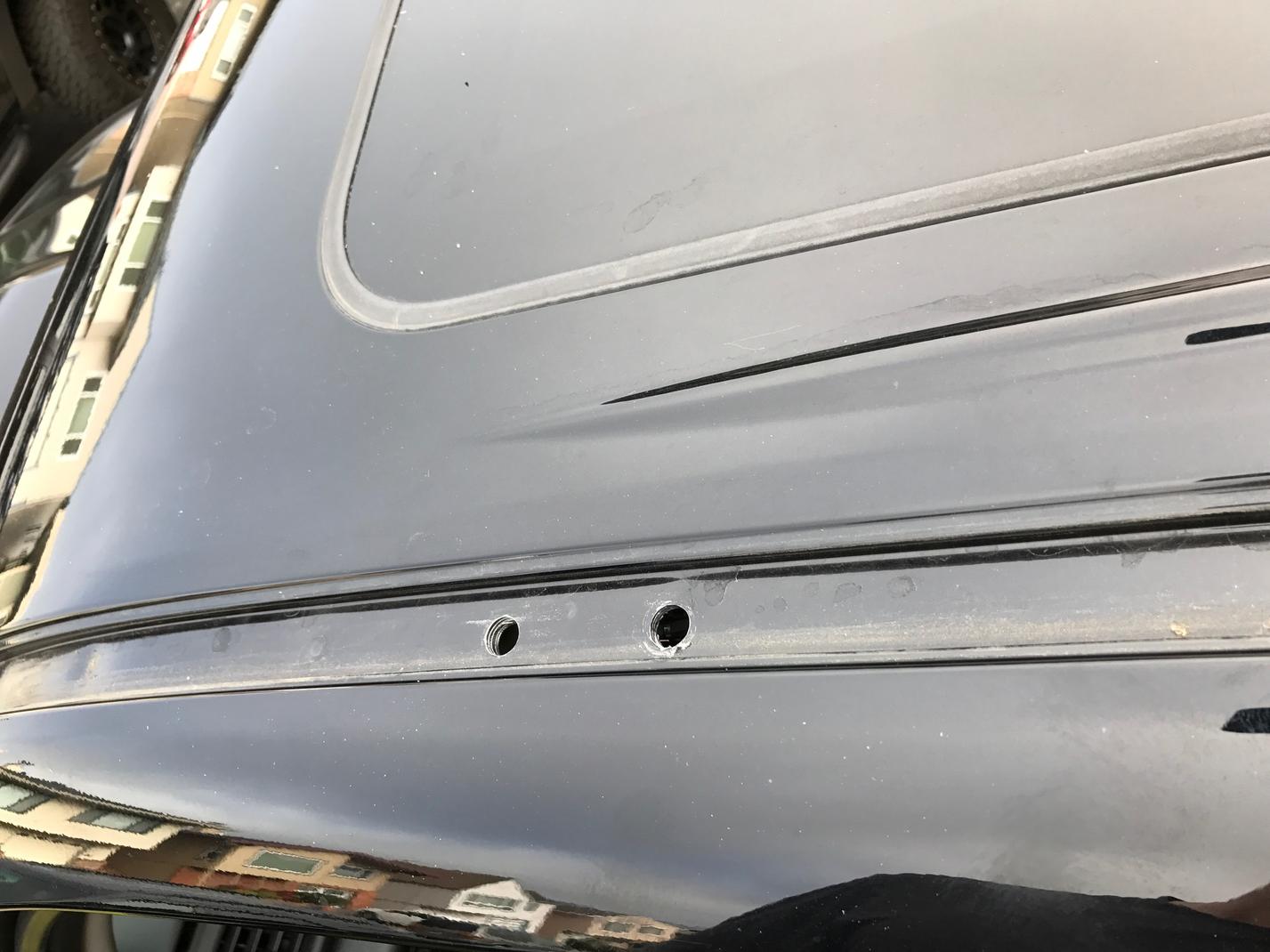

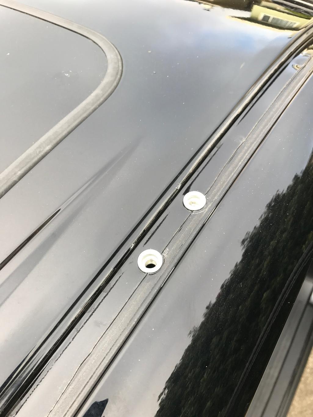

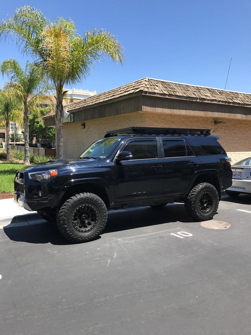

Got everything done this weekend with the help of @1G3runner who was kind enough to help with the drilling and rivnuts. The rack itself was a little bit of a PITA to assemble but the final product is awesome. Very pleased with how things turned out, apologies for the photo quality.

This is why I hate looking at everyone's rig's LOL. Rack looks GREAT!!! One of my favorites for the 4runner. I just couldn't trust myself to drill holes in the roof. I wish that I could have seen someone do it first, then I would have been much more inclined to do so myself. I love the Baja Utility Rack as well, but went with the Gobi. Every time I see one of the two of those (Baja and FrontRunner) racks....I wish that I would have gone in either direction instead of the Gobi. Everyone has the Gobi. It's nice looking, but I prefer the flat base instead. Again....looks great!

Thanks guys! Stoked on how it turned out. I will agree that I think I over anticipated how difficult the drilling would be, the longest part of the install was the physical assembly of the rack itself. When drilling you just need to make sure you don't drill too deep through since we realized the airbags are almost directly underneath the drilling points. Again, I lucked out and [MENTION=130461]1G3runner[/MENTION] was able to help with the drilling and rivnuts since he had just knocked his rack out before mine - made things go a lot more smooth for me and gave me more peace of mind. :fro:
