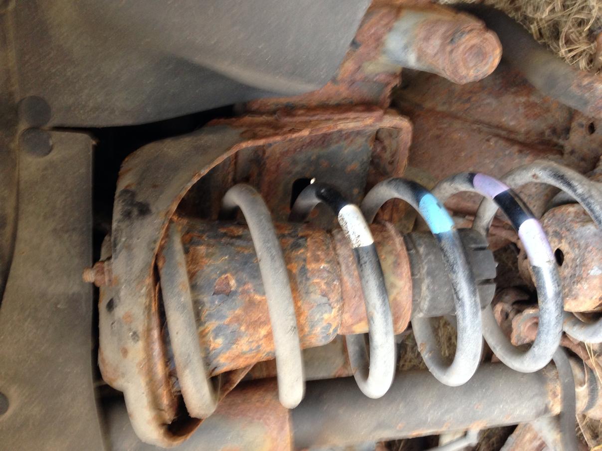

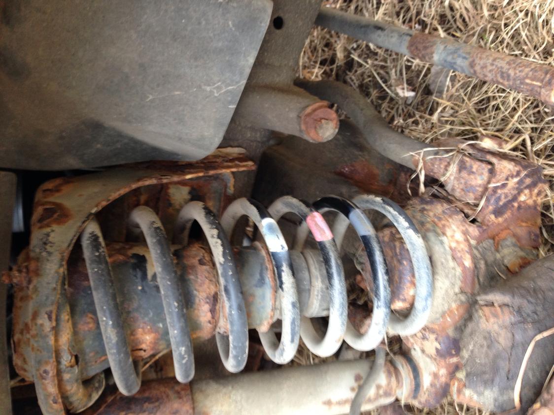

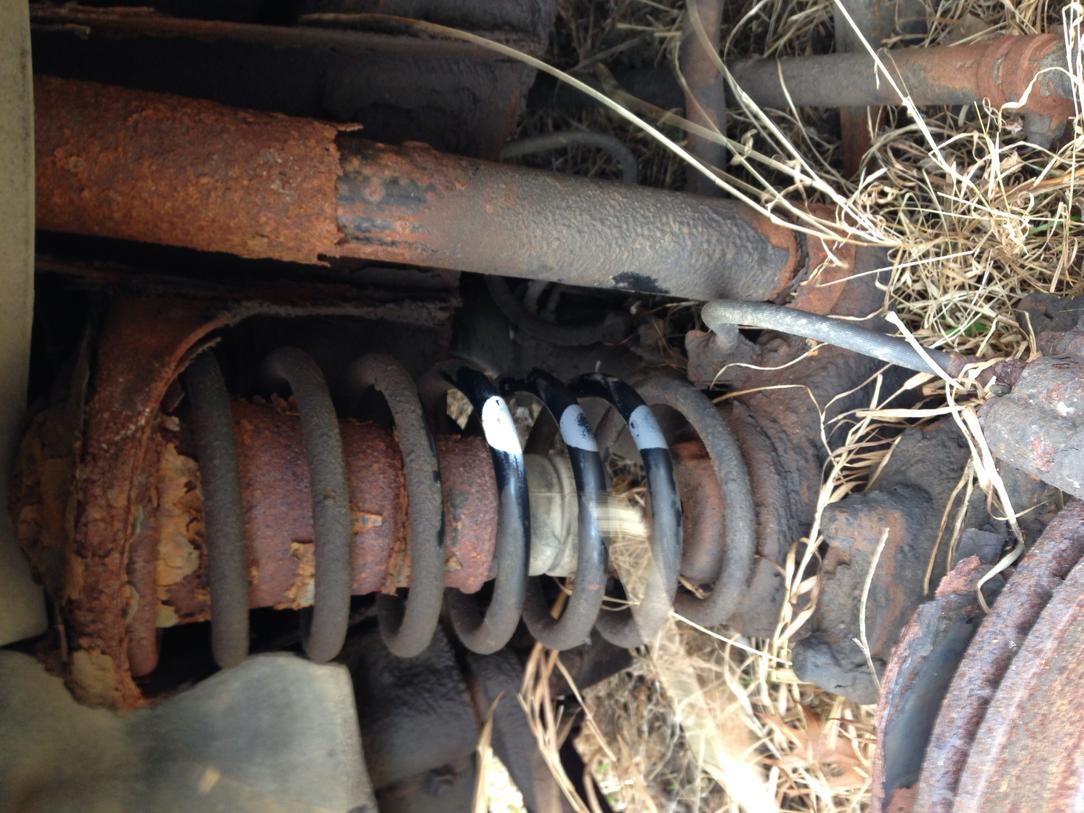

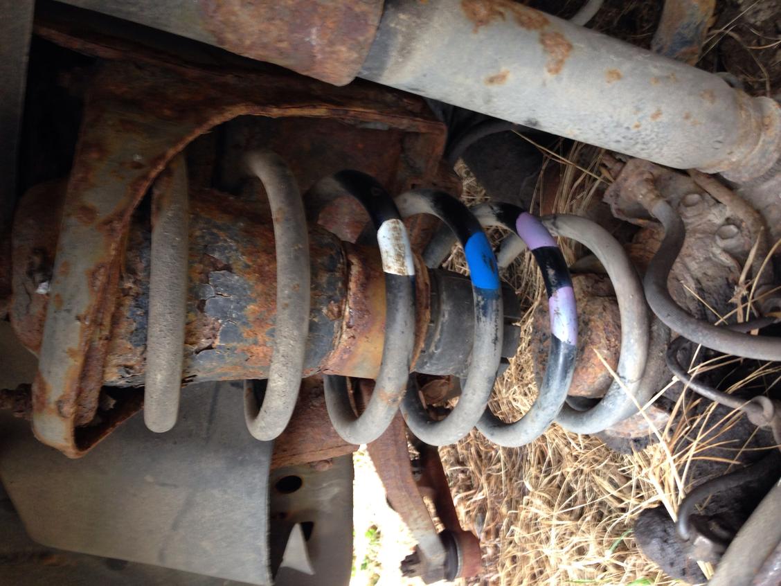

So I went to the local salvage, and poked around a couple of lc's they had. I've researched the sh@t out of the color codes, but it's not making sense to me. Before I spent the time to pull and install these, I'd like to know what I am getting. Can anyone please tell me which coils these are (they are all front LC coils)? Thanks so much in advance!

Count the wraps. The first pics I see 9 wraps, along with the blue pink white color code. These came out of 90-91 LC's and I see "90" written on the truck. The last pic you posted shows 8 wraps, with an 8 wrap color code.

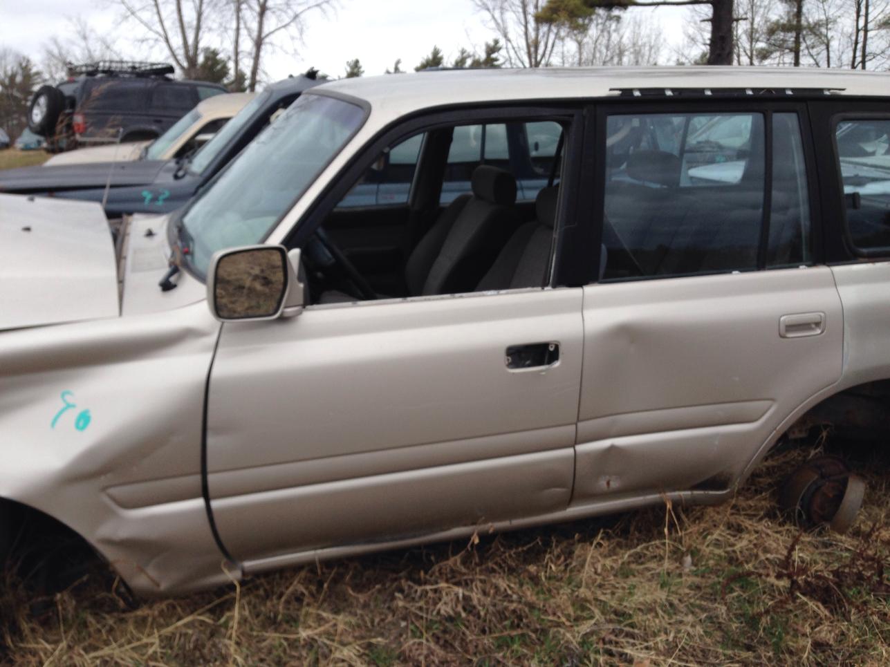

THanks down pour. I was getting frustrated as the codes didnt seem to match what were in the lc coil threads. So the 9 wraps will give the most lift I take it... is this true for all the FJ80 year ranges? I guess the other coils are from a 93, just saw that in the pics above... When I install them, the LC drivers side should go on the 4runner drivers side correct?? The LC's have the gas tank on the same side we do? I may have to read through some more threads to figure out which ones i want.,
Just measure which one is taller and put it on the drivers side. 9 wraps will give the most lift and were only on the 90-91 LC's.
