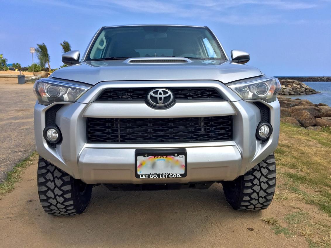

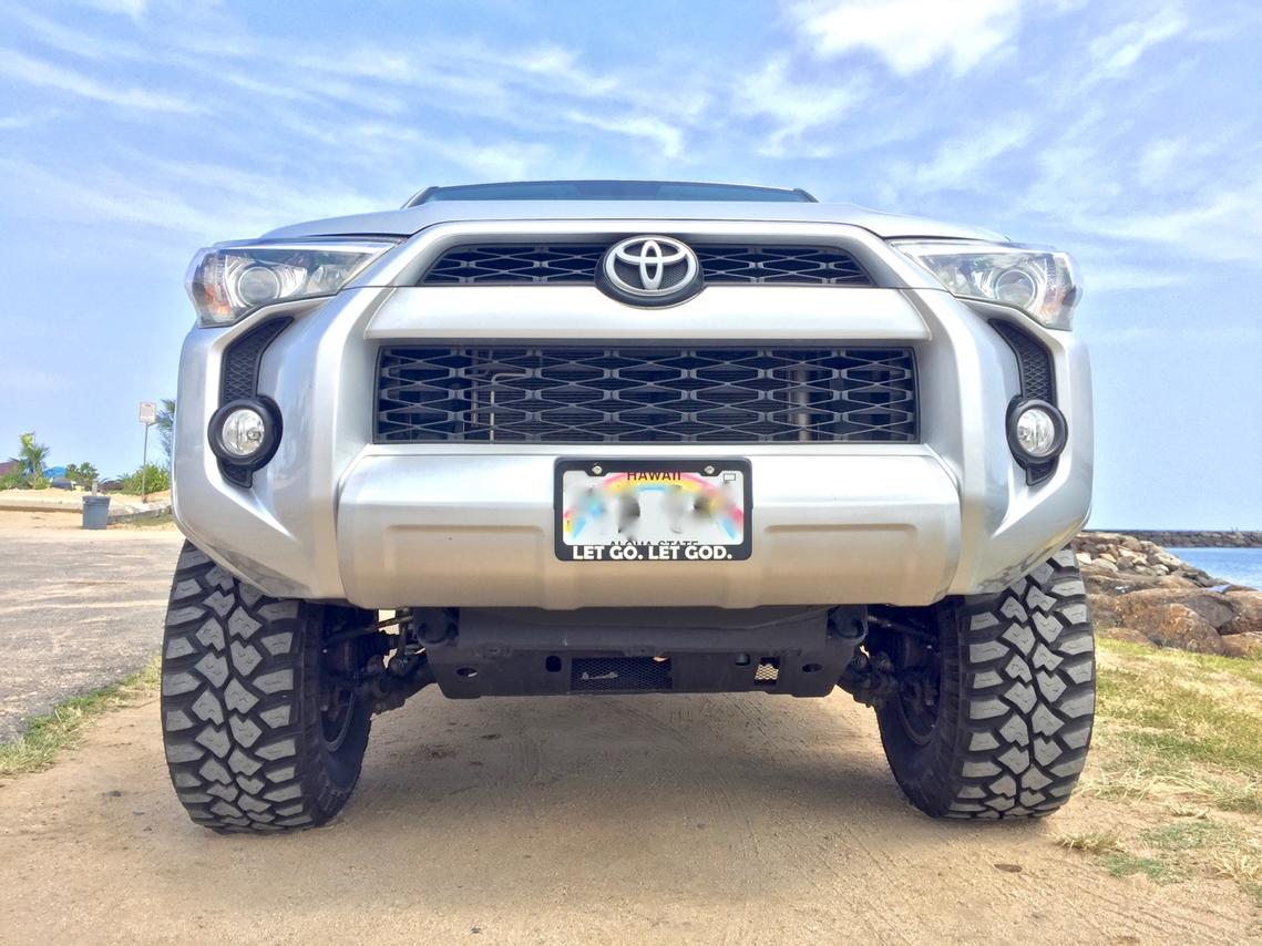

Ordered a 1/2" BL and it delivered very quick. Took me a week or two to get around to the install.
The main reason for this is to create a bigger gap between the front bumper, sliders and rear bumper. I only had a bout 1/2" or less of gap in those places. Although fitment looked nice and tight I found that while off rodaing the body and frame flex quite a bit. The front bumper was contacting the fenders sometimes and the rear bumper would bounce around and contact there as well. For the cost of this 1/2" BL I figured I wanted to give it a try on my 5th Gen. The install was pretty straight forward and made it easier with the help of a buddy. I like the little bit of taller stance it gave to it too.

This customer specifically ordered a 1/2" lift because while flexing his bumpers would contact the body. Thus a need for a lift or spacer. It solved his problem.
It depends on how your bumper is manufactured. There is always a way tho.

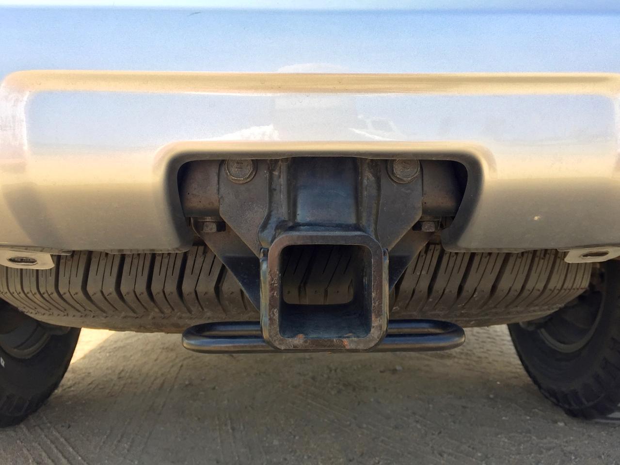

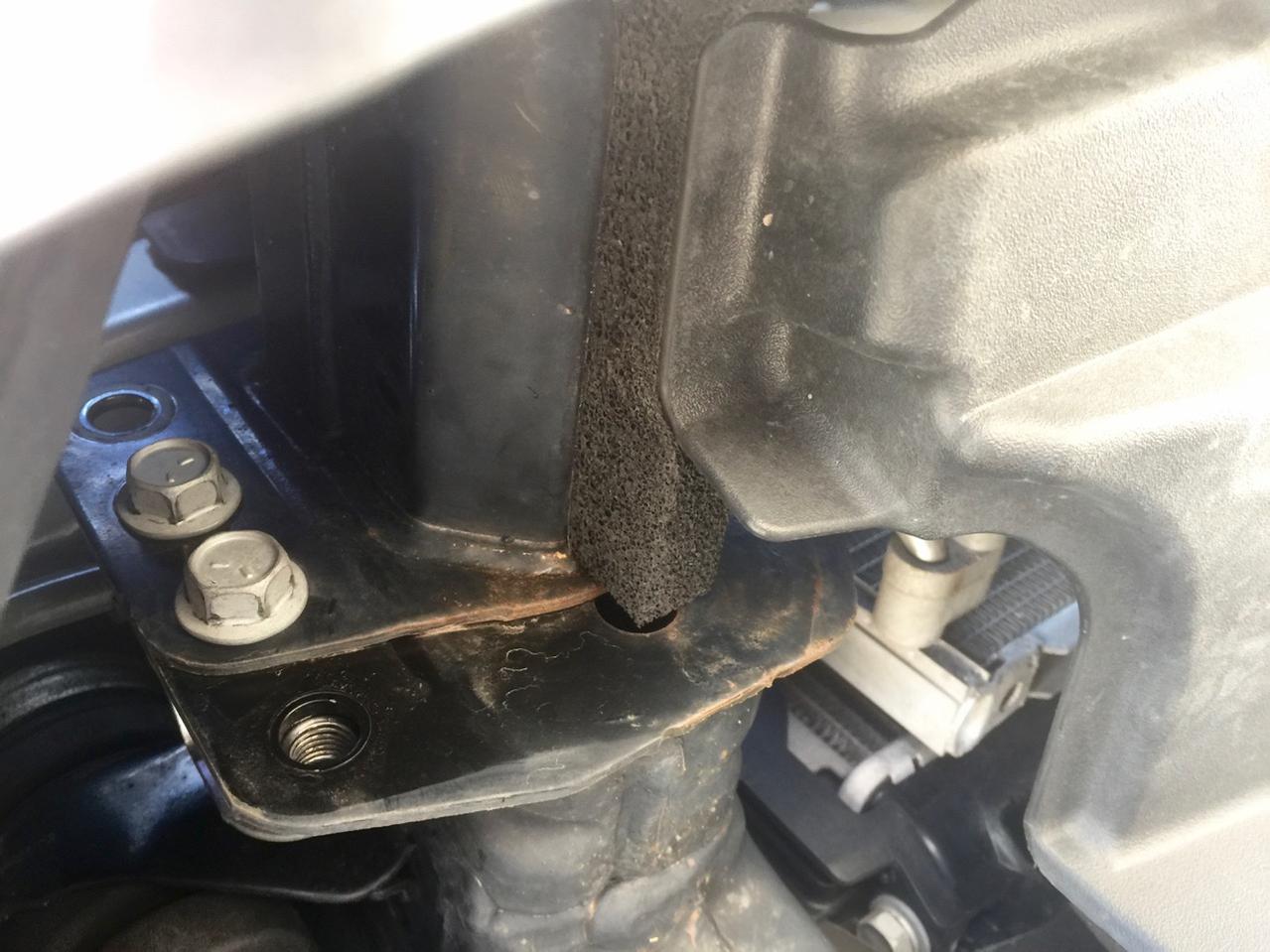

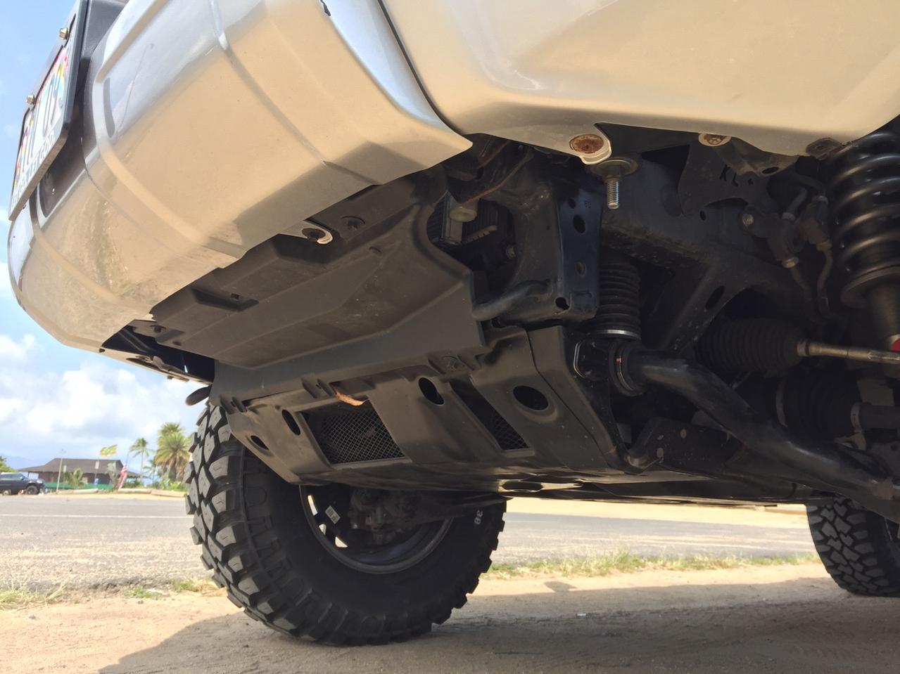

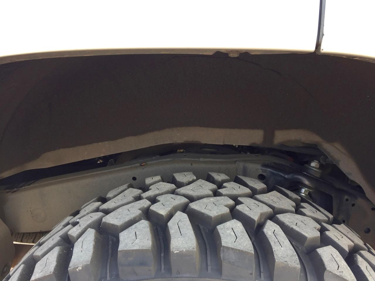

Installed 1" yesterday on my 2015 TE 4x4. Here are my install notes:
1. The bolts were slightly larger in diameter (3/4" head) than the OEM (18mm head) so we had to drill out all the body holes and washers to make them work. Wasn't a problem at the shop I did this at because they had 18" drill bits but you definitely need to get exact bolts for other 5th gen guys wanting this kit. The length wasn't a problem just the diameter.
2. No need to move nor trim radiator shroud. Didn't affect the fan movement at all.

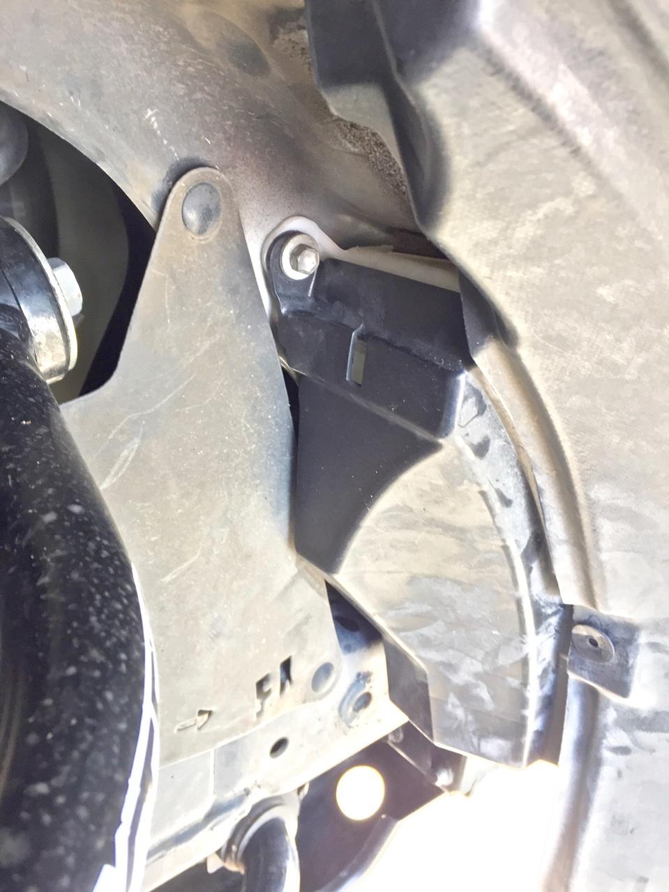

3. Windshield water reservoir bottle just needs the three bolts taken out and hung/slid out of the way to access the mount. No need to disconnect all the hoses & wiring. I zip-tied it to my UCA.

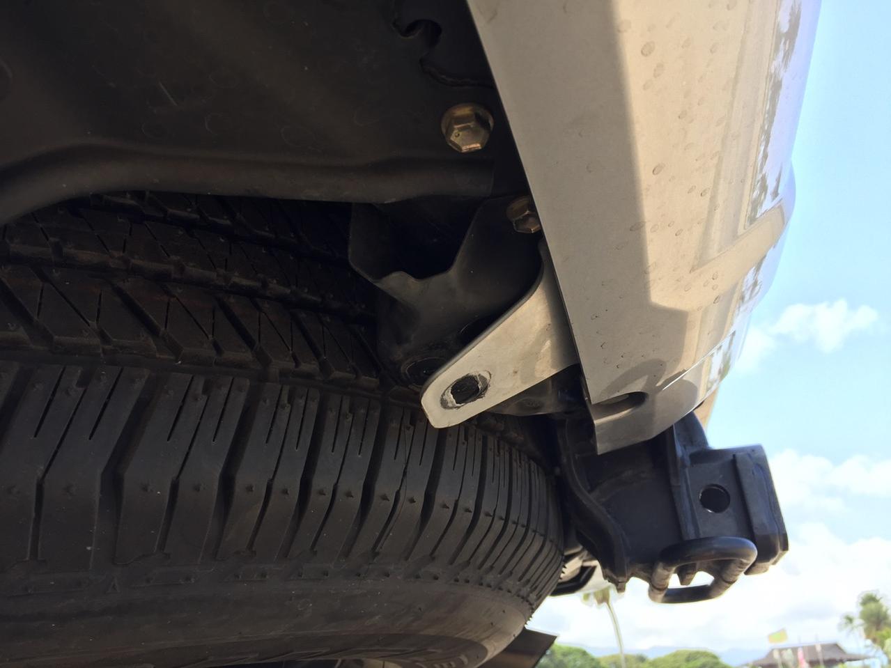

4. Front bumper can be moved up exactly one inch via its 8-bolt mounting holes and you have to in order to seam the plastic bumper cover back up tight. If not , you'll have a slight 1/8" gap between bumper and fender. By moving it up you can only use 4 of the 8 original mounting holes. Still plenty strong enough mount though. Weld it if you think differently.
5. No problem with rear bumper/cover but you'll obviously have a space now between the cover and the frame support so I'll be buying a sheet of 1" foam from a craft store and glue to pre-existing bumper styrofoam support. In order to do this though, the bumper will have to be removed to access.
6. You'll definitely need a magnetic retrieval tool that has a strong pull in order to lift the OEM body mount bolts out, particularly for the front and rear set.
7. All the interior door panels are just snapped in/out but the rear is a bit trickier because you don't want to have to remove the entire panel. We just popped about a 3rd of it back enough for as hand and tool to get in there
8. Be prepared to have plenty patience, especially with carefully removing the OEM inner fender fasteners ;)

1. The bolts were slightly larger in diameter (1/4" head) than the OEM (18mm head) so we had to drill out all the body holes and washers to make them work. Wasn't a problem at the shop I did this at because they had 18" drill bits but you definitely need to get exact bolts for other 5th gen guys wanting this kit. The length wasn't a problem just the diameter.
I find it interesting that some people report that the bolts fit, the front mounts don't fit and need drilled a very little bit, or like you all need drilled.
If I recall correctly you are the only person (unfortunately) that has had to drill and open up every body mount.
I'm not 100% sure they all didn't fit each hole because I started drilling each one after the 1st one in the far back passenger side bolt got stuck and I wasn't risking that again with the others. The two rear body mounts are the hardest to access and were a PITA because the panels don't come all the way off too easily so we just pulled them open enough to get a hand in there. You definitely need a magnet tool to get it out and make sure it has a strong pull!

Bumper mount, inner front fender, and windshield wash reservoir
