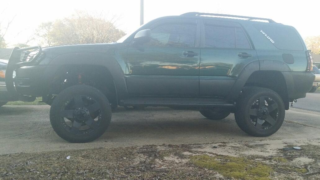

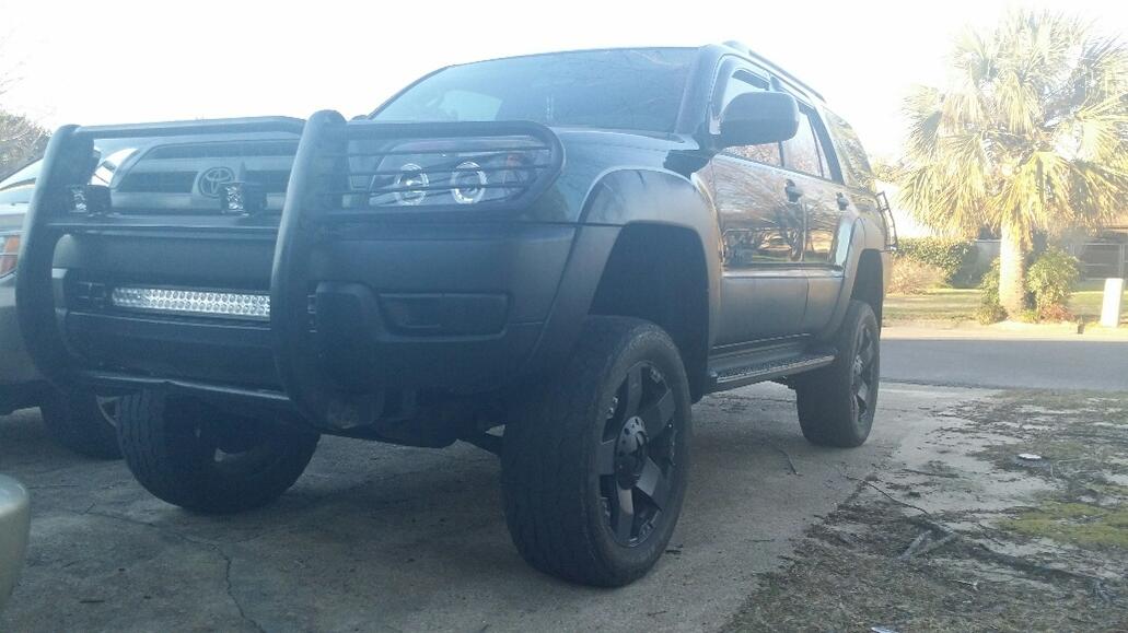

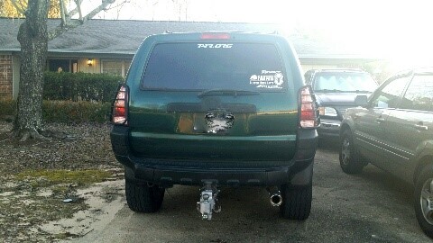

Hey here's the finish product with my lift and your body lift. Loving it and got your sticker on the back to show it off. Thanks again.:humble:
