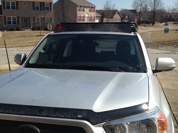

Re-adjusted the fairing and gave Alex a shout out on the back. Already received a bunch of compliments on the rack. It's awesome!

1) I don't really use sat radio, so I couldn't really tell you. Sorry!
2) It's an AVS aeroskin. Not really a bug deflector though. More of a additional layer over the leading edge to protect paint from rocks and such.

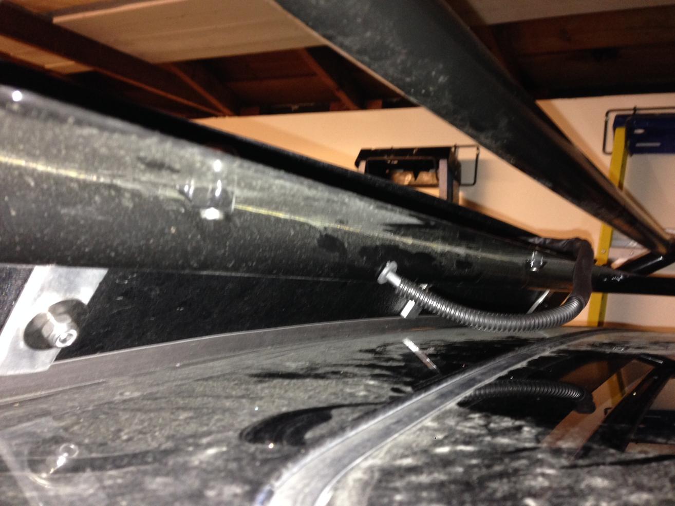

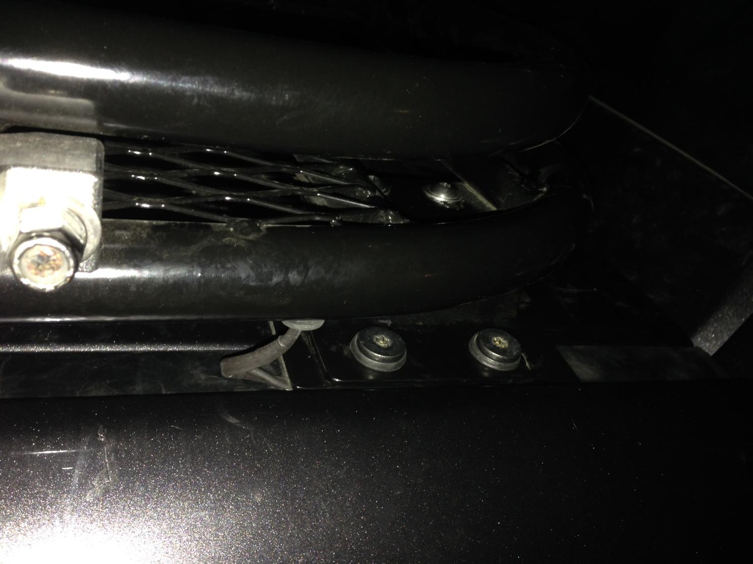

Standard one does not. I did respond somewhere with what I did which was very easy and copied most other folks in what they do sans the fact I had to drill the holes. Some quick tips:
  • unbolt the rack from the four post mounts - no need to remove from the roof
  • make sure you figure out what size hole you're drilling beforehand - I match the size to the guage wire and available grommets
  • mark and drill your holes (hopfully before you moved it - lol - no going back now
  • once the holes are drilled I used some standard hardwire to fish through the holes and feed towards the other end - once at the other end I made a simple hook another piece of wire to pull the wire through
  • with the wire now safely through each hole (in one side and out the other) attach your pre-run wire and pull the correct end to feed through the rack
  • add grommets, shrink tube, whatever you like and you're done
  • now add the deutsch plug
Here's the starting end
...and the front of the rack (excuse the dirt)

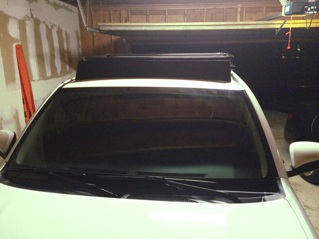

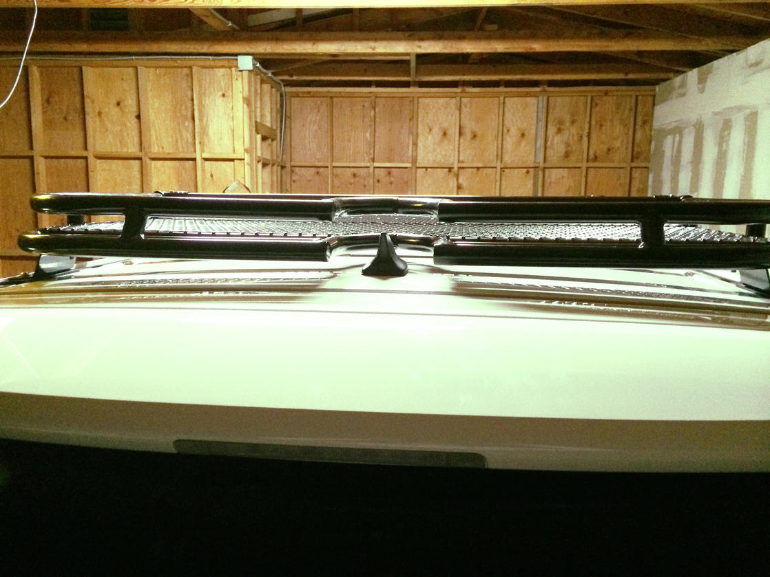

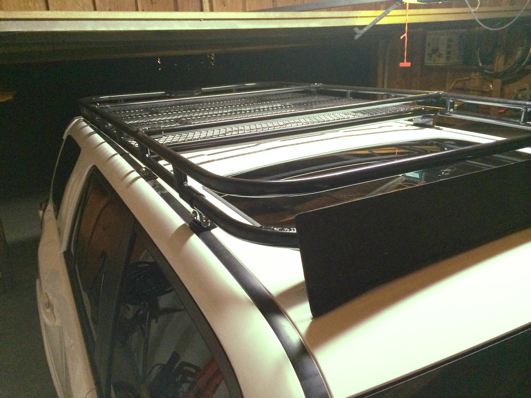

Very happy with the rack! Thanks Alex!
I will try to take better pictures soon.
