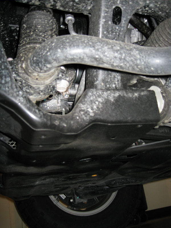

behold!
the failure/success of my skid....
success in that it did its job but im a bit disappointed (failure) in that a curb was able to do this much damage

that bent area should be straight IIRC

Wow... I've driven over sidewalks in mine and I never came close to touching bottom. You crazy Canadians must have insane parking curbs, considering the ground clearance is 9.6 inches with stock tires.
Edit: I snapped a quick pic of my skid plat from the same angle as your first pic, for your reference.
Can you take a picture of your skid plate head on from the front? Wondering what the difference is since it looks very similar to the SR5

its hard to see a comparison from the photos but its back to being mostly flat now except for one part where it pinched.
