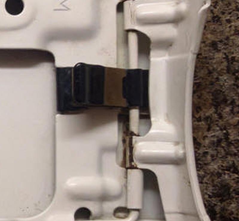

I didn't know what to look for until I saw pictures.
Seems some break at the metal V.
Others break at the plastic.
