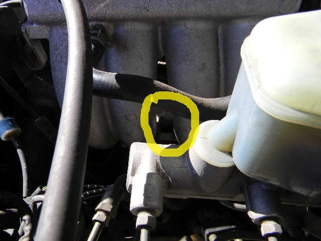

read a lot, but no one actually put all the steps or at least tips about how to replace the fuel filter for the 2.7l engine, which is a big task if you are not ready or never done it yourself, a repair shop was going to charge me 150.00 to have it replace but decided to do it myself, it took me 3hrs to do it, but I did it and save me money, no leaks, works just fine, I'll post pictures and tips that I think will make it easy for someone else out there, is it the reason of this blogs to find help and people giving hints to help others, and of couse to save money in the process and learn to know your vehicle, thanks....

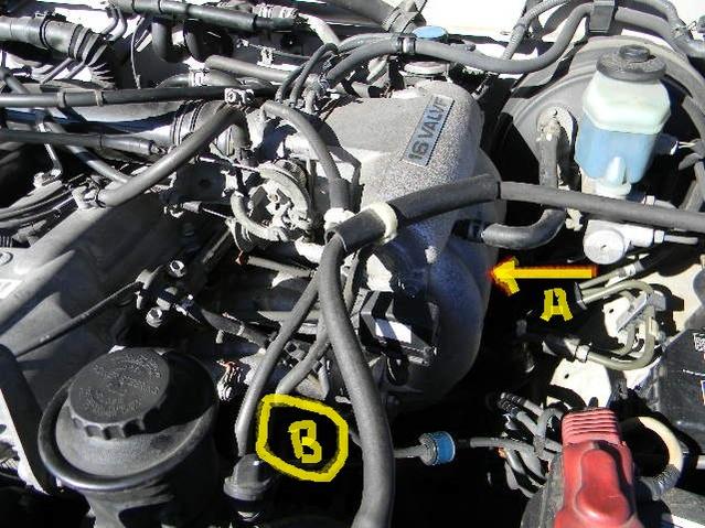

toy.jpg the A is mark, there will be a hole, where if you have a long extension, could get to the screw on top of the bracket holding the filter, its the easiest way, the B is just marking where you will find the fuel filter, check the other pics
toy1.JPGthis is the access hole from previous A marker

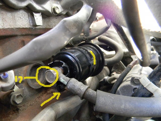

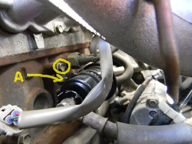

toy2.JPGhere is a pic of the filter, with a mark of the screw that is holding the filter to the bracket, now be very careful and try to keep an eye on the mark on the screw to set it up to the same distance on the holes, otherwise will end up removing the filter until you get it right.
toy3.JPGhere is a clear pic of the filter, you'll need a 17mm to remove the fuel line screw, also you can see the backet and the screw holding the bracket on the bottom..

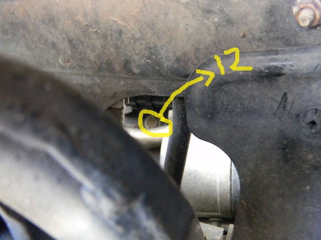

toy4.JPGhere is the view from the driver side front tire, but I have no need to removed the tire, was able to the to the bottom screw from the inside..and if my mind works, I think the screw is a 12mm, not sure/sorry

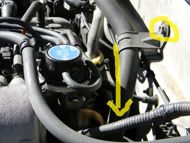

toy5.JPGnow this is one fuel line was the hardest for me, since you have no view of it or clear access to it, but the way that it work easy for me was by moving what I believe its a heater hose, from the top and it gave me a clear feeling(touching) where the screw was and was able to get it with a wrench.

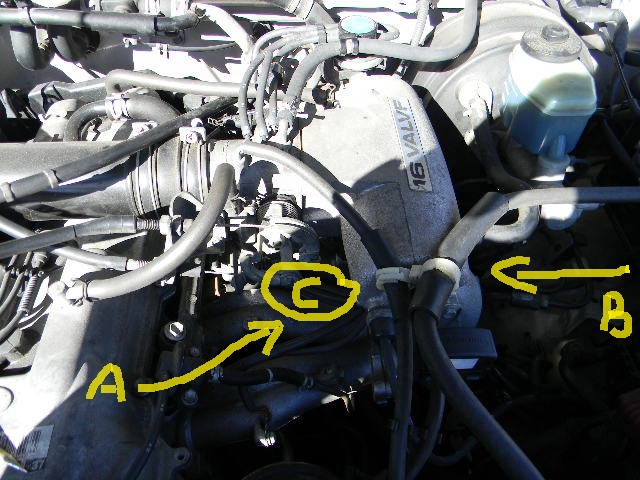

toy6.JPGand this is the last pic to give you, I want to say to help anybody when installing the new fuel filter, thru hole B and hole C gives you access to put or hold the screw in place til gets to the hole so you don't end up dropping and looking for it for a few minutes, again its just to help, I'm not a mechanic and nor an expert on it, but I hope by looking at these pics and hearing different ideas can give some one the understanding on what to expect, just keep an eye on those screws and good luck, and keep a bowl or towl ready for some gas leaking out or the lines, good day...

It can be done.
It can be done without too much hassle if you are so inclined. Takes 1-2 hours the first time, faster the second I'd guess. Not as bad as it looks.
Can all be done from the top of the engine bay. Only had to move a hose or two to get arms down there. Maybe it was a wire, not much anyway. Worst part is, you are working nearly blind 'cause of the location under the manifold. Get the wife's hand mirror down there so you can see what you are working with. I propped a flashlight down there somewhere too to light it up.
Longest part of the job was sorting out what tools would fit. I used a short wrench for one, and a long wrench for the other banjo bolt. A socket with a short extension for one, and a long one for the other mounting bolt. I think a universal flexer too.
I used an OEM filter and had no leaking issues. Good job to figure out at home so you can repeat it on the side of the road if you ever need to.
