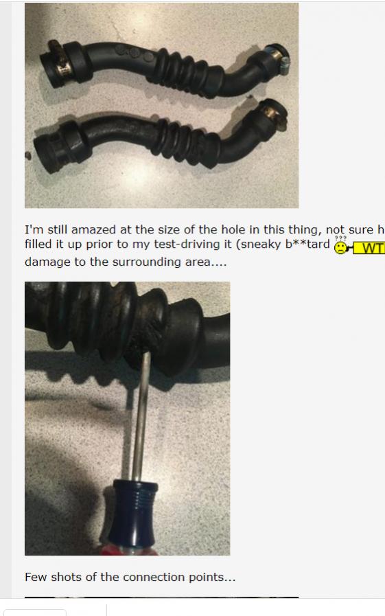

03 v8 4x4 limited... A rodent (or something) took some bites out of my fuel inlet hose (part #77213-35371) and now I'm spilling more on the ground than into the tank when filling up. Toyota has discontinued this part and I haven't had much luck finding a similarly sized replacement. Has anyone found a workable solution for this? Perhaps the 35380 from the gx470? It has a similar shape, but looks a little short.
Pic of part attached

Rockauto shows that Toyota P/N being "SPECTRA PREMIUM FNH230 $24.99" in the aftermarket world. Pretty cheap too. Looks like O'reillys also sells it for way more.
RA lists that as fitting these models.
LEXUS GX470 2003-2009
TOYOTA 4RUNNER 2003-2009
TOYOTA FJ CRUISER 2007-2014
Oh man, said that this was their last one! Ordered it. I hope their inventory is true!! Thank you for the tip!
