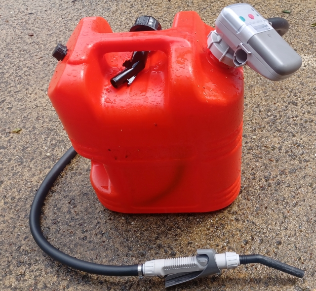

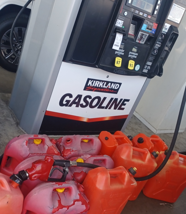

Concluding that siphoning will never get all the water out, the next day I begged my friends for their fuel pumps, and with those in hand, I laboriously pumped out the rest of the fuel (which took a few hours) as I raised and lowered the front and back to angles it has never seen before. (The last cup of water was gotten with the rear wheels on the ground and the front jacked up with a big floor jack with wood blocks on the jack).
Now it was time to FILL 'er up (and get my windshield washed for free in the rain, just like my Dad said they did in the olden days when you got your tank filled for you at the gas station).
This fuel pump I borrowed from my friend works great.

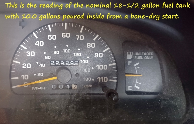

I added the first jug of 5.0(something) gallons of gasoline and checked the gauge reading where I was surprised that it wasn't 18.5 divided by 4. Instead, it read essentially what 20 gallons divided by 4 would read.
Hmm... that's surprising.
Moving on, I drove about 1-1/2 miles (for reasons related to the repair) and then I parked it and added the second jug of 5.0(something) gallons.
The gauge reported the same oddity of almost perfectly half full (with 10 gallons in it now).

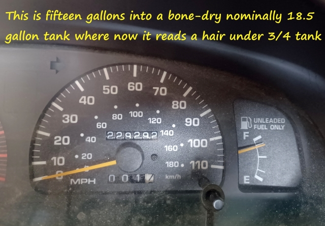

At 15 gallons, it still read oddly in almost-perfect five-gallon increments.

2. My sending unit is calibrated for about 5-gallon increments
3. For all but the topmost quarter tank (which is about a 4-gallon increment)
So, my gauge seems to be reading (from full to empty) at 4-5-5-5 gallons respectively (Full, 3/4, 1/2, 1/4).
Actually, if I consider stopping at the empty line, and the fill line itself, it's probably reading closer to 3-5-5-3 gallons (Full line, 3/4 line, 1/2 line, Empty line).
