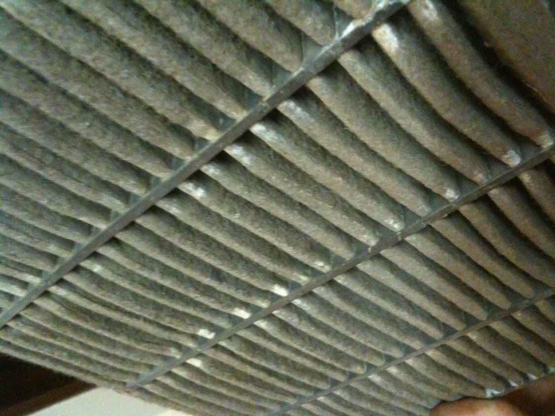

air filter doesn't seem too dirty (does it?) ... a lot of red dust came out when I shake it out ... see attached.. you think i need a new one??

SAE40 and 20W-50 might as well be molasses, toyota calls for 5W30 if im not mistaken (i use 10W30 full syn). i agree, replace the air filter and take a look at the maf and see if its dirty too.
Yea, change it. You should also check to see how your spark plugs look. Both are an inexpensive fix.

We had to change the air filter on our farm vehicles very often. If you are in a remote location you might consider buying a K&N or a Fram Air Hog filter. They can be field serviced with a recharge kit and a few hours to dry.
ok, first stop tomorrow is a new air filter! and oil ... is there any reason the guy would recommend 20w50? Climate? it gets very hot out here in dry season ... dust? very dusty in dry season too ...

The guy who changed your oil must have been a baboon. Dump out the SAE40 and put in 5W30 or 10W30 ASAP. Get a new air filter and clean your MAF as well. You can check the Tutorial and Documentation reference for any guides. Make sure you use at least 87 Octane fuel as well.

well i put in a new air filter and replaced the oil with 5w30 ... and filled up the tank, so we'll see how it goes on milage this time around. I feel like it has a bit more power just from this ... would it be that noticeable???
