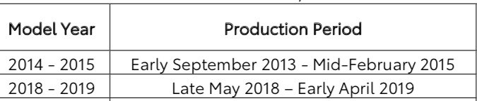

I wonder if the fuel pump becomes a regular maintenance item. So every 5 or so years it goes bad? Does anyone know if the part that was installed is a different part number than the original part number that got recalled?
