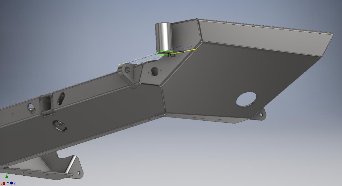

Working on the swingout mounts at the moment:
I would think to better protect the swingout spindle, wouldn't it be best to recess it away from the surface of the bumper? If you back into something, drop off a ledge, or hit it going up a steep angle you could risk damaging it and messing up the alignment of the swing arm.
Thanks for bringing that up - the swingarm hinge arrangement is still a work in progress, so nothing about it is finalized; I'm open to any good suggestions! However, since this bumper is made to be high-clearance with crawling in mind, there's no real room behind it to recess anything in below the taillight - anything added to the basic structure has to go outward. And while I agree that recessing-in would definitely look much better, creating the space for that would probably mean having a big blocky bumper back there, and I didn't want that - keeping it as high and angled as possible was an important design objective for me. :)
Accordingly, the swing-out hinge assemblies are going to be a bolt-on (removable) addition, but they'll have gusseted plate mounts and won't stick out beyond the angled lower plane, so it should be easy enough to ramp the mount so that ledge drops aren't as risky - and should take a good hit or two.. and in their current sketched position, they'd allow simple, straight swingouts to lay directly atop the shackle mounts so as to reduce the load on the hinges in travel position. (Those shackle mounts are 1" thick and tie into the frame rail & rear crossmember.)
It might be possible to find a heavy duty bearing-style hinge that is smaller in diameter (this one is 2.25"), but I haven't run across one yet. (I'm trying to design to a readily available hinge assembly)
(Oh - and also, they are below and do not block the taillights; another important consideration for me, personally.)

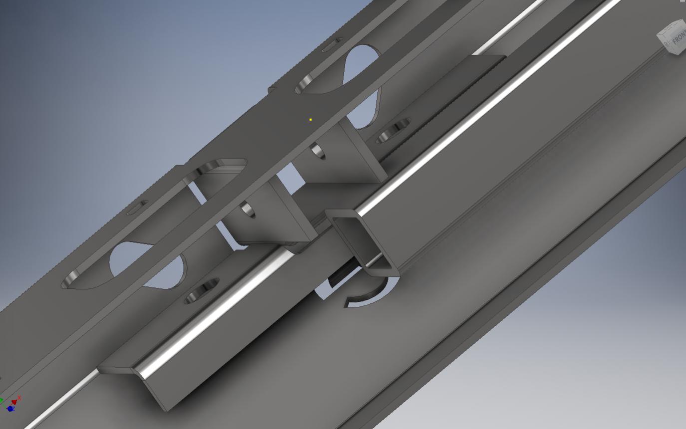

It would be helpful to know if the swingout could be limited to 90 degrees rotation, or if it needs to go further than that for any reason? IF I can limit to 90, I can build a pretty stout boxed mount..
Ok Charlie, backside view (don't share with anyone, top secret):

I also think more than 90 degree swing out is best but I feel like I could live with 90 degrees no problem.
On my CBI I have to extend it past 90* due to the hatch hitting. I don't know what the contributing factor is to the reason for it. It's likely just due to where the spindle sits. You would probably have to have the spindle further out (width wise) to get the 90* angle. Too close towards the inside of the truck and the swing arm will be in the way of the hatch.
ok, cool - thanks!
