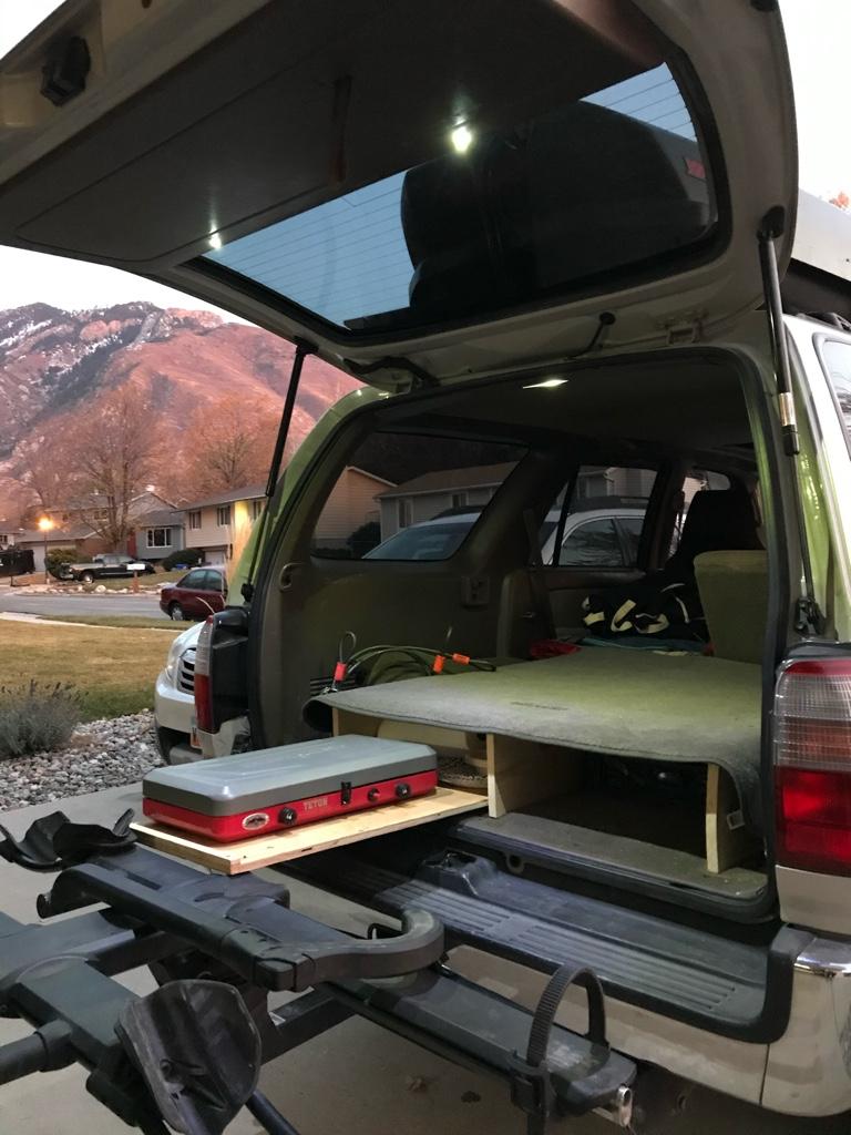

yep, build a simple box that ends up the height of the wheel wells for your matress pad to lay over. Keep in mind the higher you build for storage underneath, the less headspace you have to sit up and crawl around. I used 1/2" thick ply slapped on top of 1x8" pine as a frame and boom, sits level with the tops of the wheel wells. then attached the 4 runner OEM carpet/rug think on top.NO splinters and SO PRO. Like you said, don't go wild if you're just spending 1 weekend a month. Don't worry about tailoring the box around into the nooks of the wheel wells with flaps and lids n junk, you wont even notice plus it gives storage for the right size items like a tall skinny water tank, portable compressor, stuffing a nalgene etc etc. You'll have to decide how to bridge the rear seats to continue a flat spot from your rear cargo box. If you don't have to worry about human passengers on your trips, SO EASY, look up some buildouts for ideas. Unbolt those seats and get a bunch of storage underneath. I had to get creative to work around a third passenger.

+1 on no drawers, but I still made a pull out for one side and actually use a trays in the other,way in there, to hold smaller items like straps, tool roll etc that I can pull out and carry around quick. You’re going to want something like that If you put anything down there that can move to the front out of reach. Obviously not your rifles.
That table for my stove doesn’t have to rest on my rack, I used scraps and made an “L” shape that sticks up up in the back and keeps items from sliding off the back. You just have to make sure you don’t pull it too far out, pretty obvious. Basically a big lever that tries to lift up the whole box when it’s pulled out. It literally sits and slides on the carpet. Attach the box to the truck using L brackets that take advantage of the tie down ring’s bolts instead of those silly turn buckles.
