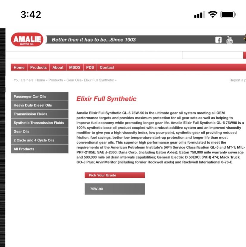

I run Amalie Elixir full synthetic gear oil. According to Amalie, it has up to 500,000 mile oil drain intervals capabilities. I once heard a mechanic say the 30k drain interval was overkill. I would agree that would be overkill provided no towing or wheeling. I’ll probably just inspect every 30k and only change if it looks dirty. I run this in my Tacoma that has 315k miles and I only charged once and have not had issues.
