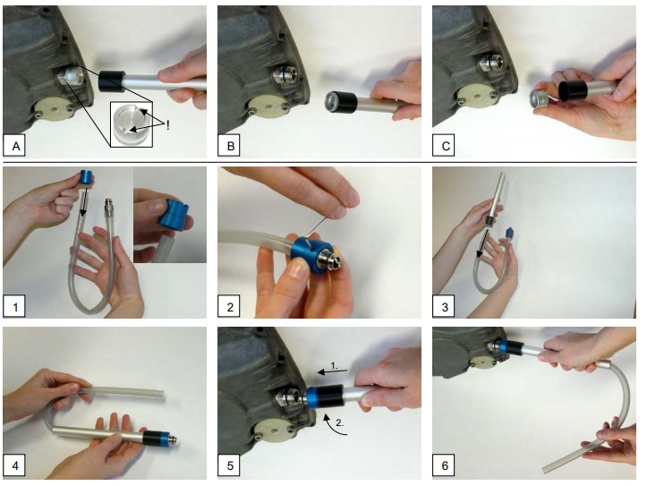

Here's another option...I recently installed a Stahlbus drain valve and they offer an extension tool to use to open and drain from their valve. I have Bud Built skids so there's enough room for my hands.
