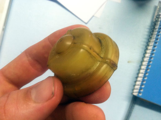

What is this thing? (95 V6 3.0L Auto)
Found this plastic piece floating around in the engine bay... no idea where it should be or if it's causing any of my current issues...
Anybody know?
