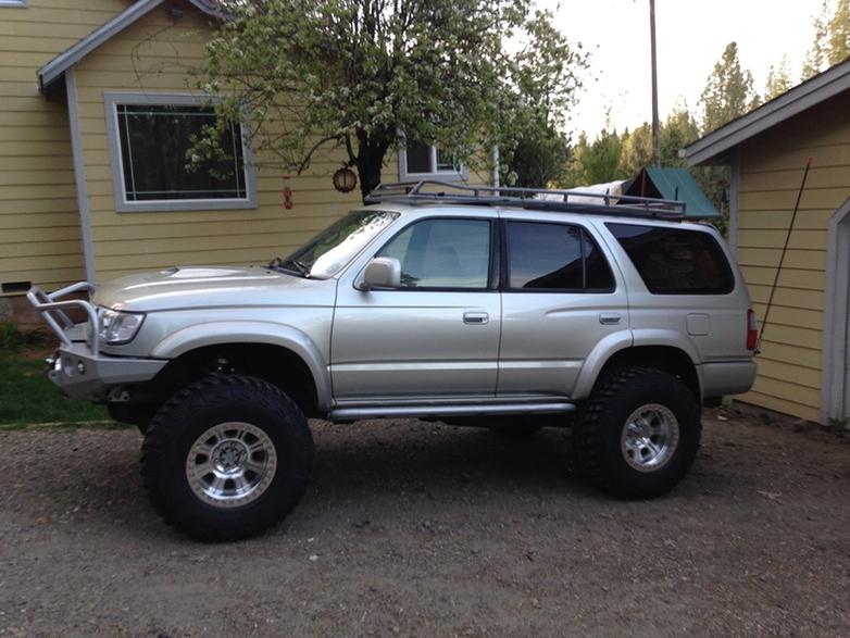

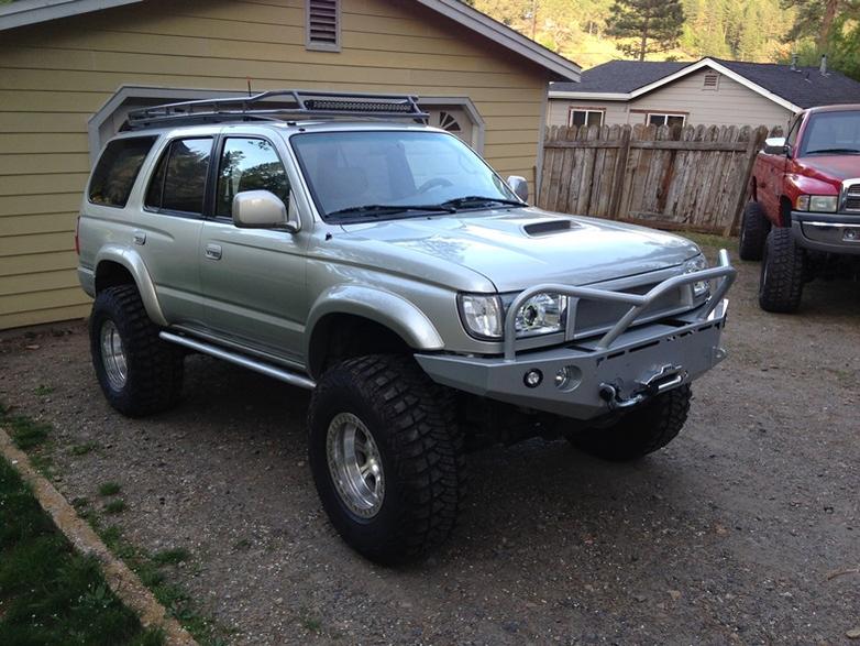

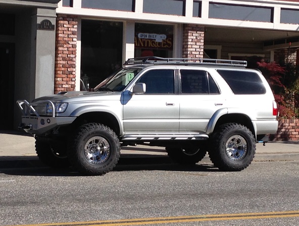

I'm running a toytec 3" and 1.5 bL, and 35's
The SS 1.2 and then adding a 1" BL is essentially a 4" lift.
