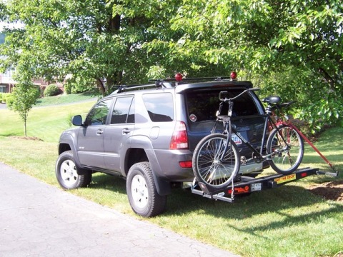

Here is another pix from this summer. You can see its got a spoiler and I wired the lower lights to work witht he break and running lights - the reflector mod. It's a V6. Still have all the stock springs if needed.
I feel ya on the stance and not wheeling it- should have come from the factory with the 3 in lift. Too nice to thrash. I do run it in 4x4 once a month. Have all service paperwork and park it inside everynight and detailed every other month - she's a queen.
Here she from the back with the bike hauler.
