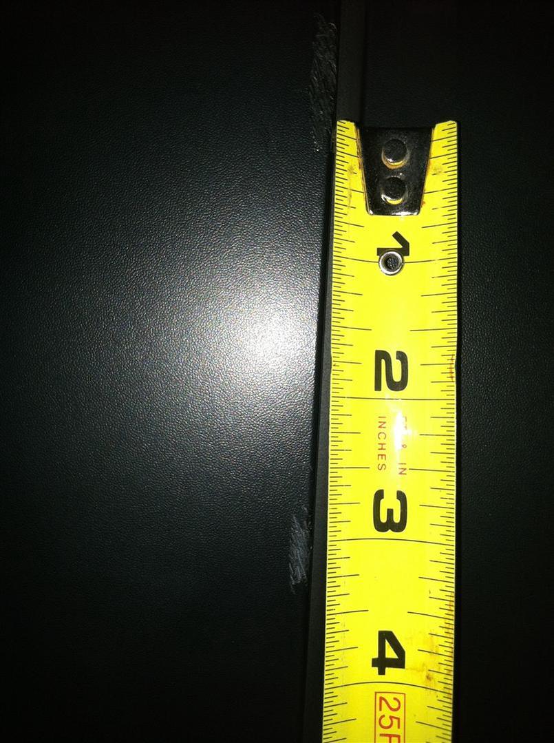

I sometimes rest the driver side door on some shelves in my garage when I get out, and over time it has started to leave scuffs on the external plastic door trim. (hardly noticeable and no big deal to me) Check out the distance between the two scuffs. The top scuff is before the lift and the bottom one is afterward.
After everything was said and done, lowering the front 1/4" made all my problems disappear.
