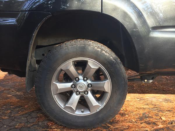

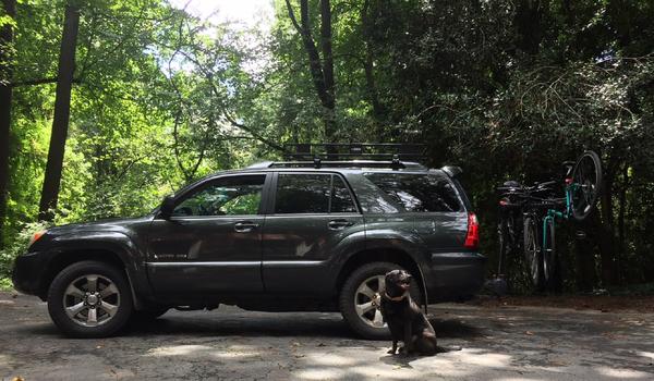

Originally, this is the stock truck with just a Surco roof rack on 265's. Suspension was soggy with body roll, but nothing I didn't expect out of an old truck. Still, she had plenty of traction and never got stuck on trails or the occasional mudhole.

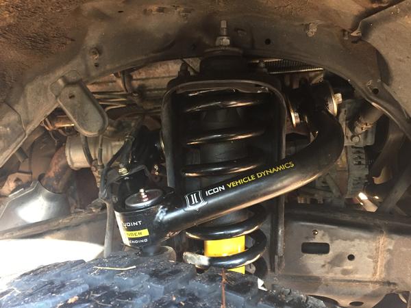

Icon Upper Control Arms & ball joints

Original plan was for Icon UCA's, 2.5 EMU coil lift front & back, plus a 1 inch stacker, and all new replacement steering componements. While the truck was torn apart, like always, the guys found the LCA's were rusted tight to the CAM bolts. So new LCA's were needed & associated CAM assembly parts for alignment. Pain in the a$$, but I expected something else to possibly need replacement as well.

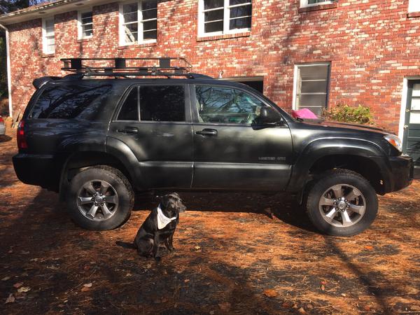

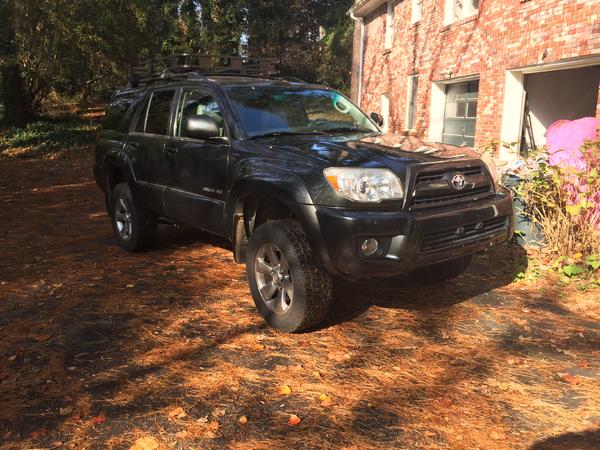

Here she is after everything.
Still have 265's since they have so much tread left. After it all settled in, I couldn't be happier. She handles much better than stock, and the front stiffer coils for the v8 did not result in any rear rake as feared, and aren't much stiffer than the rear if at all. She sits pretty level once the front settled in.
ga-v8-albums-2007+v8+limited+build+-+++stock++rock-picture49089-front-shock-assembly.jpg
