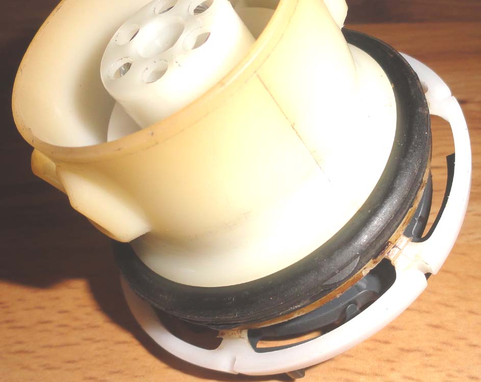

My T4R 07 SR5 O-Ring flatten due to me adding 2-3 clicks vs 1 (as instructed on or inside door). A good indication it had flatten and was not sealing was it w/n push out to be removed (vs I had to pull it out.
About the same time all the related lights came on and a replaced cap solved the issue. I see some are referring to replacing the O-Ring. My O-Ring w/n just a traditional O-Ring causing me to replace the cap at a local auto store vs original.
I save the old cap for later experimenting. I noticed the flatten O-Ring came back to a full round shape while resting on my workbench in 2-3 weeks. I took the old cap by a State Inspection Station and it passed off the T4R and the next year on the T4R. The Local Auto allowed me to return their cap which w/n fit the holder and it had only been on and off once.

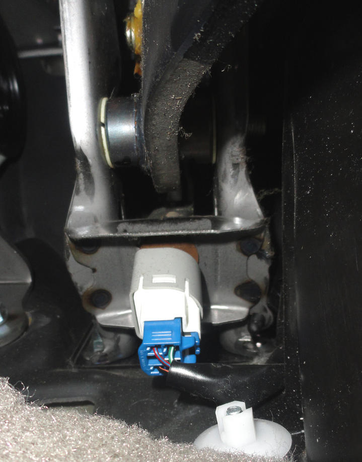

I did get the lights months later occasionally but they would go off during the same short trips. The Owners Manual and a Tech explained this is normal if the lights do not stay on. Initialy the tech thought my brake light switch was the problem since it takes 2-3 tries to get reverse at times. With brake lights working and going into reverse, the Tech said “all is Good, Come Back if the switch goes bad”.

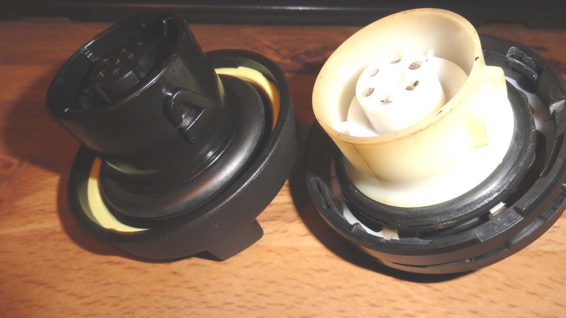

See the matters attached:
