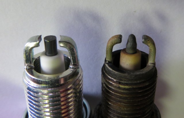

What spark plugs are you running. Good doesnt mean correct. You should use double ground double platinum plugs. Single ground plugs wont work well in these engines. I gained 2-3 mpg when I swapped mine out. I prefer the Denso brand.
I believe they were Densos. IDK about double vs single. I didn't change them out when I bought the rig since they were good. They were serviced by Toyota FWIW. I'll plan on those double ground ones.
Like this? Couldn't find Denso
You gained gas mileage with double platinum? Huh I'll have to try those. I put in regular copper and while those smoothed out the engine, there was no mileage increase. Thank you.
They look like this
These Trucks have the wasted spark system so the ground acts as an electrode on 3 cylinders. Ordinary spark plug get chewed up quickly and the arent as efficient.
They look like this
I have the dual electrode but not the platinum. I have a few things I have to grab from Amazon, I'm going to grab some and throw them in. Thanks again.
