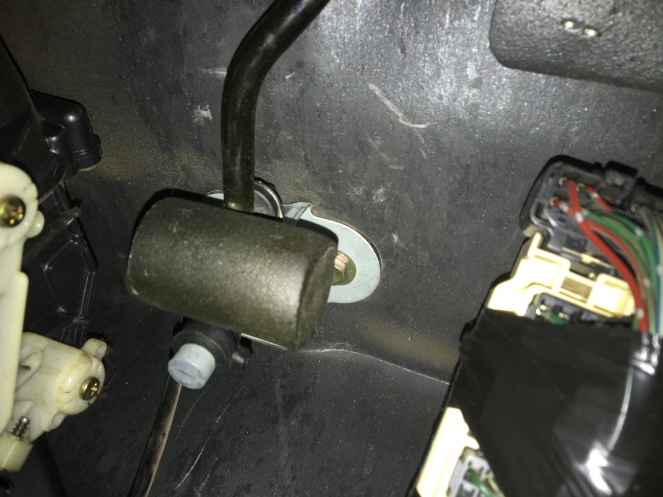

You might have just saved me from doing a full engine swap! ok JK but seriously I think this was the problem. Just looked under at the bushing and its fried! Building a new bushing now. Will report back. If this is the solution then this thread needs to be added to the Maintenance section cause I'm sure others will need to know this.
Problem solved
Special Thanks to [MENTION=168172]sleepydad[/MENTION] for the video. Turns out that little bushing was the problem. Watch the video for an in depth look at that bushing.
To go a long with that my pedal ALWAYS had some play in it. I just thought the throttle cable was the culprit but it was this bushing wearing out. Now the gas pedal is stiff and I can accelerate much easier since there isn't half an inch of unusable play.

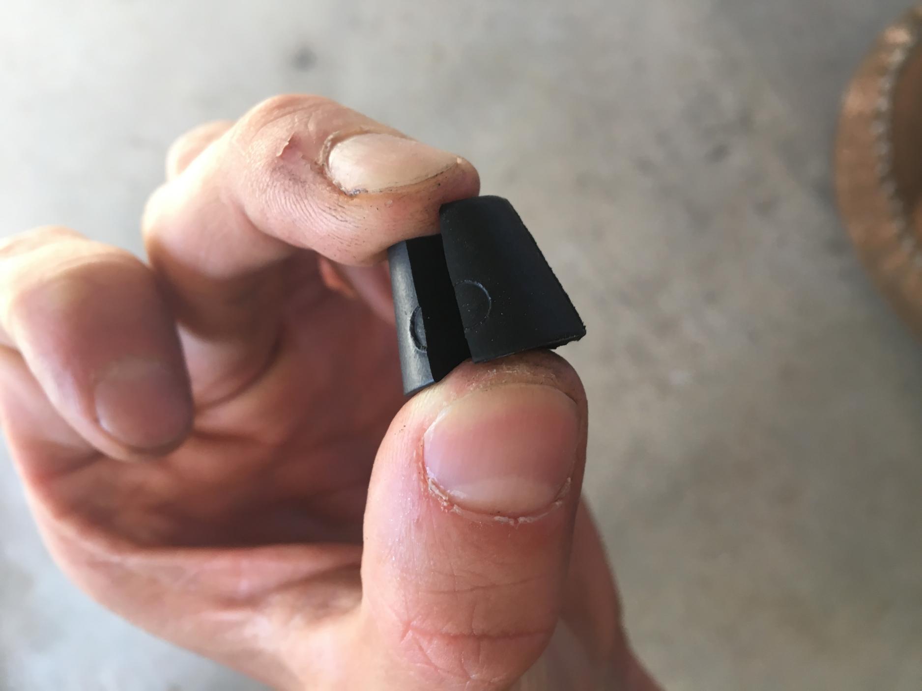

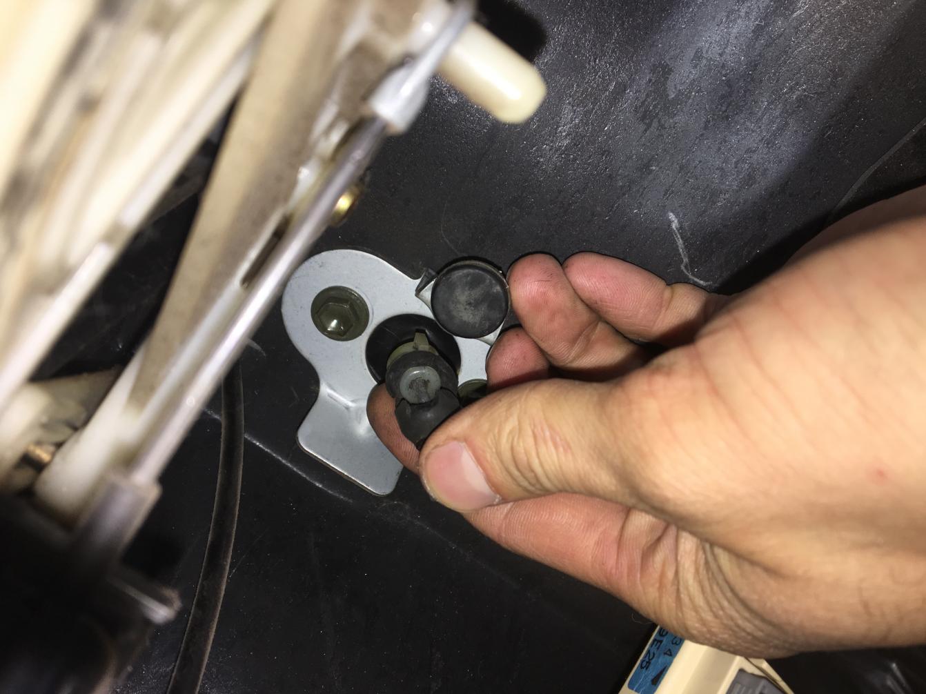

How I fixed mine: I had a little rubber "stopper" that fit perfectly. I drilled out a hole that would just fit the cable into. Slid it onto the cable, then for piece of mind I put a zip tie on it to secure it.
Obviously a new cable would probably be the way to go, but this is very cheap solution that is working just fine.
I'm not sure how to make this a sticky but I think it should be cause this little bushing is probably failing on many third gens as they age. I had no idea it was even there.

Yes the bottle stopper is a perfect fit and should mend it well.
