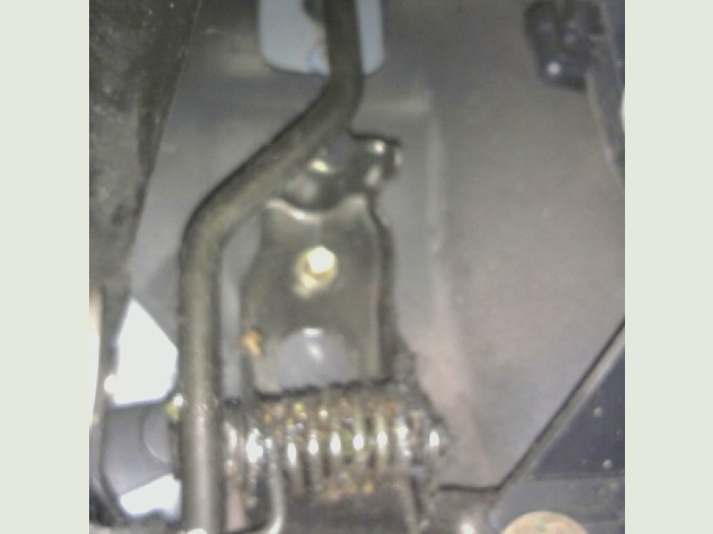

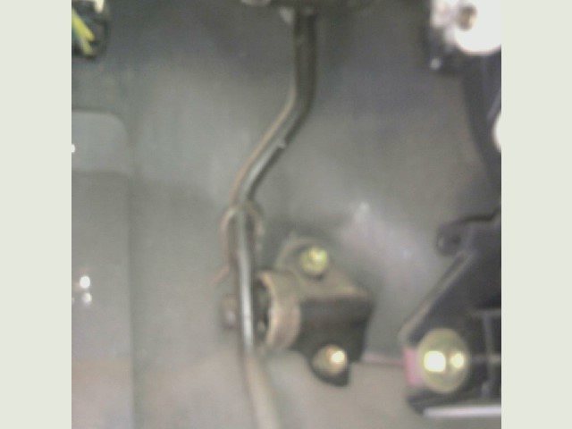

Its the design. Here are two pictures of gas pedals. The one with the smaller spring is from my 1998 4Runner. The larger spring is from my 1995 Runner. Its obviously this spring that is making it stiff. My question is, are these pedals swappable? I would like to put the 1998 pedal into my 1995.

A few weeks ago the cable on my 87 started binding halfway thruogh its travel. Decided to buy a new one from the dealer, oh soooo much better now. Feels like I am driving a Porsche in comparison.
I sprayed PB blaster up inside mine from both ends and pumped the pedal a whole bunch, now it is nice and feels like a proper Japanese 4 banger. :)
