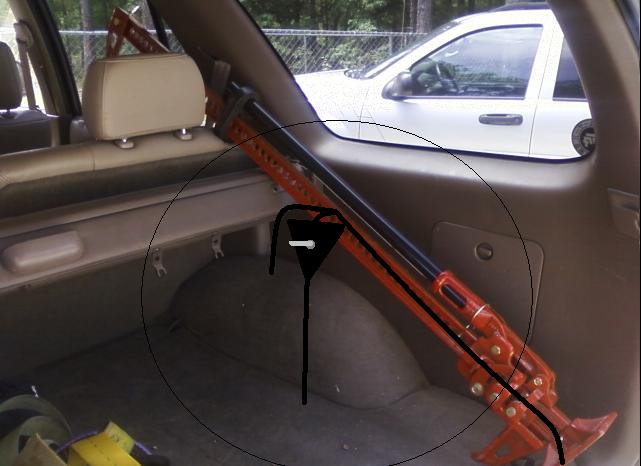

It will be a really tight fit back there for a 315/75 but I think it's possible. Now I just need a mock up tire and wheel to see. I think I can borrow one from a friend for a test fit but here is a "ROUGH" pic of what I have in mind with the possibility of having mounts for a 60" hi-lift jack.
Don't criticize my drawing too badly :hiding:
Of course the tube will be thicker and the 315 will be taller than the drawing. keep in mind this is a rough sketch.

Keep in mind you will have to make several different sizes of mounts for each tire size if you plan on selling them. The mount for the 35 will me taller than the 32. I know I'm stating the obvious but you will have to get several tire sizes unless you plan on just making the one for the 35 and then a 32 or 33 will not touch the ground.
I'm going to use a sliding mount that will move up and down the tube so it will accomodate any size tire. I didn't explain that earlier and you definitely can't tell by my drawing but good looking out.

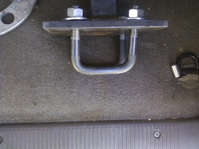

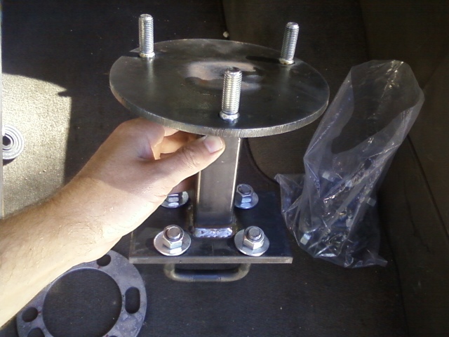

I got sidetracked on this project with all the honey do's and also didn't keep on top of the fabricator to get completed until this week. Here is phase 1 of 3. I "plan" on knocking this out quickly now.
