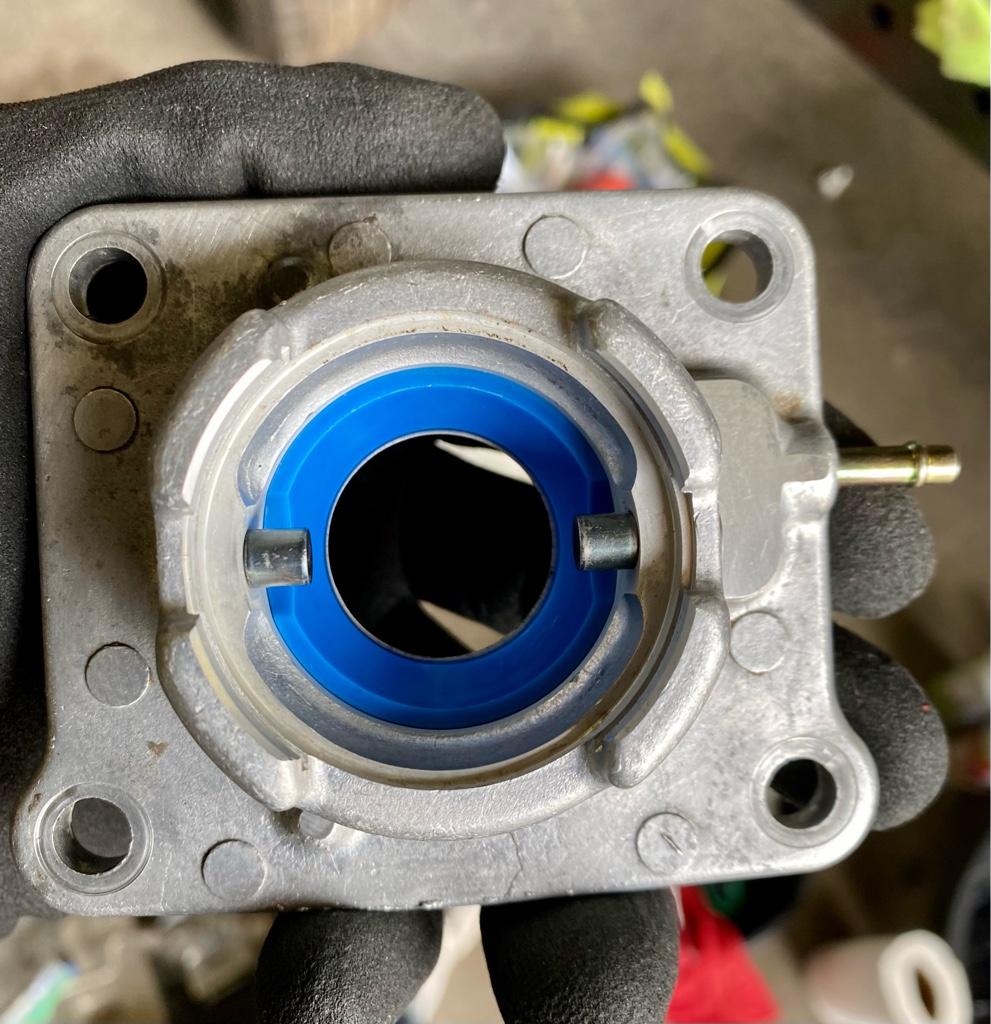

I'll order the Marlin seats for the t-case and trans. We'll see how it goes. $15 for shipping those seats and a HD shifter socket is borderline highway robbery...

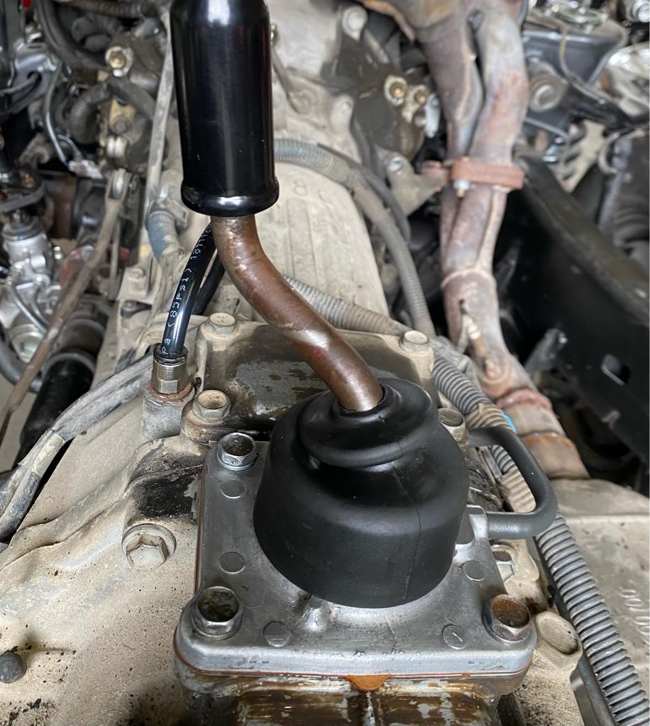

I finally got around to replacing the shifter bushing with the Marlin one. The old one didn't look bad and neither did the housing seals. There isn't much noticeable difference in terms of the smell as there's still a faint smell when accelerating and a strong smell when entering the cabin a few hours after a drive.
I did notice some air flowing from the boot into the cabin. When the shifting assembling was taken out, it seems that there isn't much to prevent this.
Uhhh... the boot on the transmission to the shift lever should be sealed AND the boot from the shift lever to the body should be sealed. Is either/both ripped/torn or not sealing?

I think Charlie has it here. There really shouldn't be any smell coming through. We live in ours for extended periods and it is smell free in this regard. Is the top of your transmission covered in oil or something?

After messing around with transmission/tc fluid changes and cabin mods/swaps I, too, had the unwelcome smell of gear oil in the cab.
I googled it and found this thread. I didn't have to look further than the body rubber boot, it was out of the groove on the shift lever and "leaking" gear oil stench.
Easy fix. Thanks, team!

What's the factory PN as an alternative to the MC part?
IIRC, I don't think that shifter seat bushing has its own PN, and is only sold as part of the whole tcase shifter assembly.
EDIT: The MC part is worth it IMO. Shifting in and out of 4LO is a much better tactile experience. Used to be "crunchy" and "notchy", now it's smoooooth.

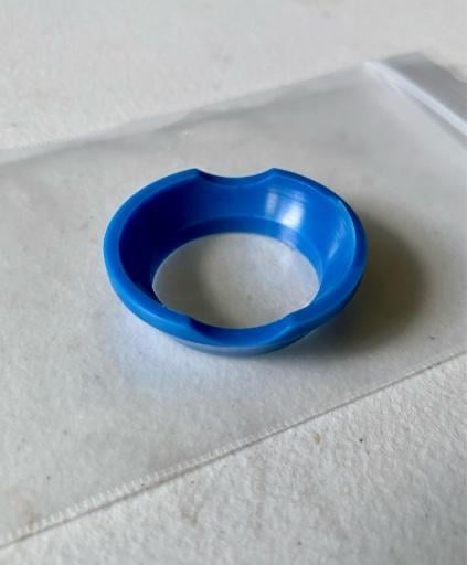

Does the J-case take their blue seat?
Sent from my Pixel 4 XL using Tapatalk
Yep. MCTM-523 Heavy Duty Shifter Seat (Blue)
You’ll also want Toyota parts:
- Gasket 3634535050
- Oil Deflector 3610835060
EDIT: Interesting to note, my blue shifter seat bushing came with what looked like a few little imperfections. There was a small and very thin "lip" sticking up past the top along the inner diameter of the bushing. Also one or two little "burs", from what I assumed was related to the molding or milling process? (I'm not sure how these are made.) Probably didn't need to, but I shaved that lip and the burs down with a sharp little pocket knife and made sure everything felt smooth before install.

No additional gaskets/parts needed for the transmission seat replacement. If you look on marlin crawler's website at the seats it has a how to video for the transmission seat towards the bottom: Heavy Duty Seats | Marlin Crawler, Inc.
