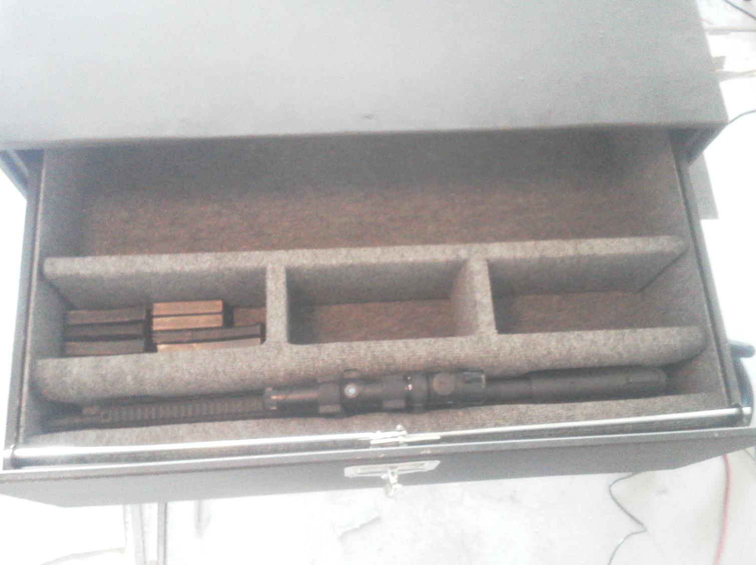

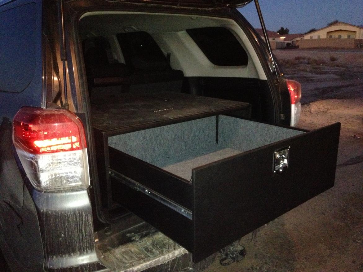

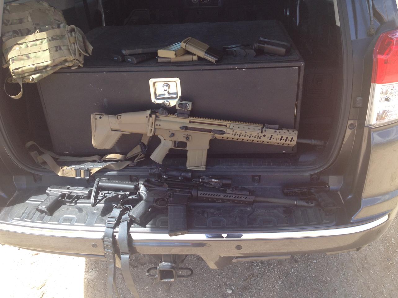

This is mine, I'm able to lockup my duty gear without worrying about theft (unless the truck is stolen) while out running errands. The box is mounted to a frame which is then mounted to the 4runner's frame, that way I can remove the box, but the drawer would need to be removed first so it's pretty secure. Way better built then my SWAT guys Tuffy box. Holds a lot of recovery gear when out on the trails. Might mount a ARB slide out to mount a fridge or some other ARB drawers to make it modular...

Need more info on this box!
Very nice!

I love what you did to your scar, is that a hk45c? And great design for your cargo area.
Thanks, the SCAR is slick. Yes, HK45C and P30 in .40 just a couple in the HK stable.

Thanks. I made a thread on this box awhile ago, I'll try and dig it up. This was made by a guy in my dept and he started doing them on the side, so they can be made to any dimensions you'd like.

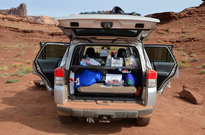

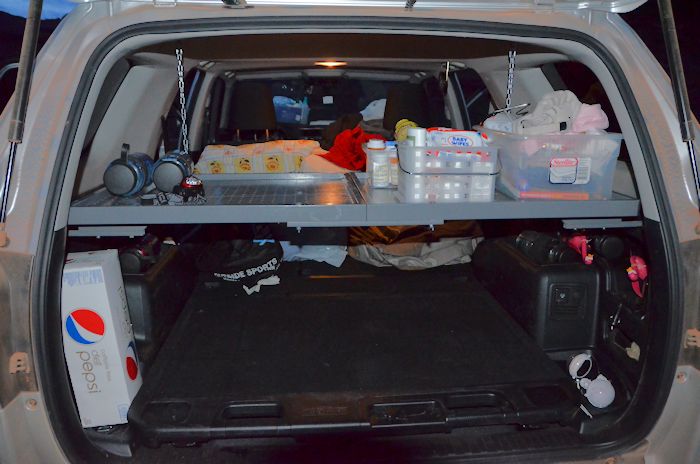

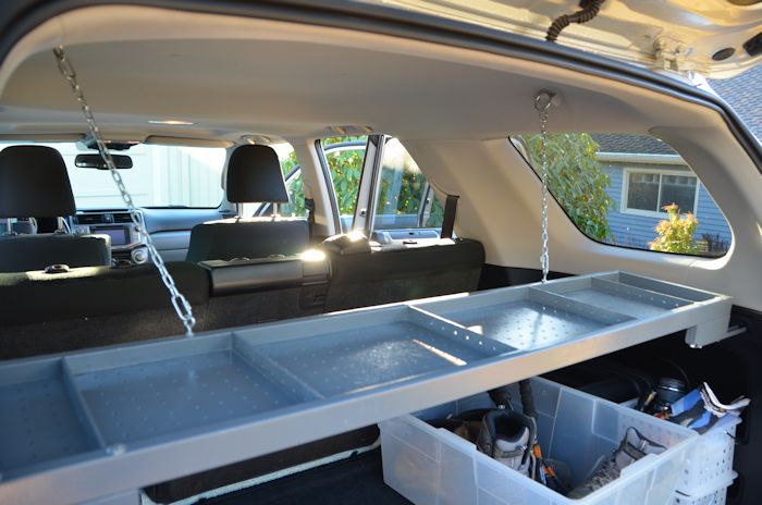

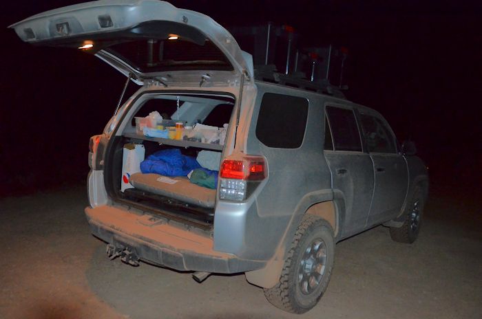

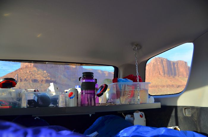

Car-camping Night Shelf

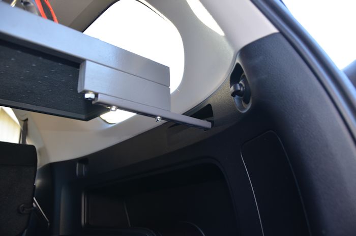

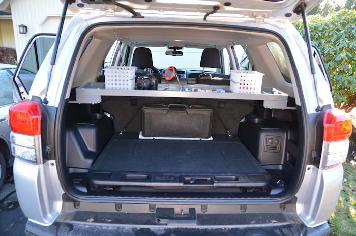

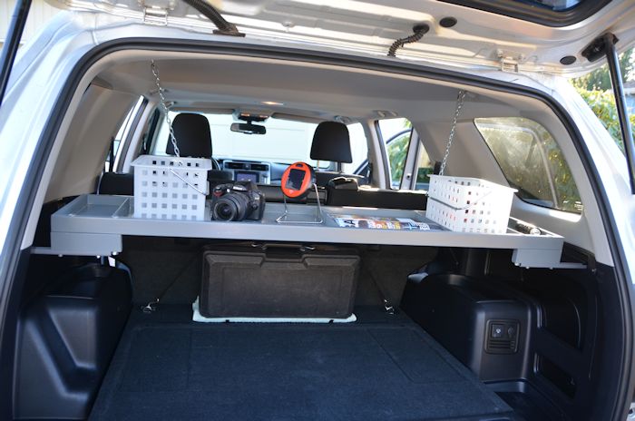

While not strictly pertaining to "cargo" per se, this put-your-stuff-here-when-sleeping-in-the-4Runner shelf has made it much nicer when we spend nights sleeping in the back of our 4Runner. I posted a few pics up on another thread, and someone PM'ed for more details, so here goes.
Shelf 1.0 was for built for our much-missed but too pavement-oriented Mazda Tribute, and when we traded it in on the 4Runner we decided that a new, bigger Shelf 2.0 was in order. It was made in two pieces to make it easier to pack and haul around, but quick and easy to bolt together when needed. It's initial use was on a 6-day, 5 night trip around the White Rim Trail in Canyonlands N.P., and it made the trip much more enjoyable - and anything that helps with the wife's attitude after 6 days without plumbing has gotta be a good deal.
It's supported by 2 chains hung on the hooks in the headliner and by a couple of brackets that slide into the cargo cover mounting places in the rear side panels. At night, the usual stuff lives on the shelf, and it's mounted high enough so that even with the 8" thick airbed our legs and feet fit underneath. After the trip, it was decided that there was really no need for the bigger size, so I made new chains and mounting brackets for the smaller original shelf so it would fit the 4Runner.
The design is real bonehead - the perimeter is just lengths of 1"x2" fir with a 1/8" groove dado'ed around the inside, pegboard is used for the shelf surface and dividers, and I ran a bead of wood glue around all the joints before painting it. The brackets that rest in the cargo-cover mounts are just shelf standards with the ends ground down to fit and then wrapped with electrical tape to avoid scratches. I need to re-locate the chain mounting points (from the Mazda) so the chains hang plumb, and re-do the bracket mounts with a single piece of 1"x3" or whatever that goes all the way across.

[MENTION=80158]dsfra[/MENTION] - You don't travel will stuff on that top shelf do you? Looks like some potentially deadly projectiles up there.
