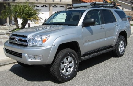

teotwaki Senior Member Apr 5, 2006 #1 New Revos! 265/75/16 load range C Attachments revo_side.jpeg 45.6 KB · Views: 470 Last edited: Apr 5, 2006

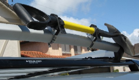

teotwaki Senior Member Apr 5, 2006 #3 Shovel Mount Attachments clamp shovel.-1jpeg.jpg 30.6 KB · Views: 460

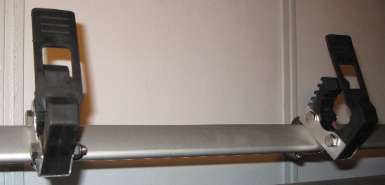

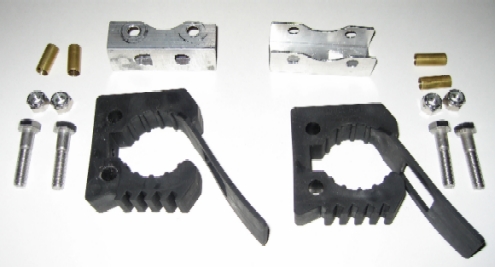

teotwaki Senior Member Apr 5, 2006 #4 Home made mount system based on Quick Fist clamps, brass tubing to prevent chafing, stainless bolts and locking nuts, 1" aluminum tube Attachments clamp kit.jpeg 74.5 KB · Views: 627
teotwaki Senior Member Apr 5, 2006 #5 What the assembled clamps look like when mounted Attachments clamps mounted.jpeg 89.7 KB · Views: 492
