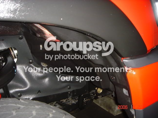

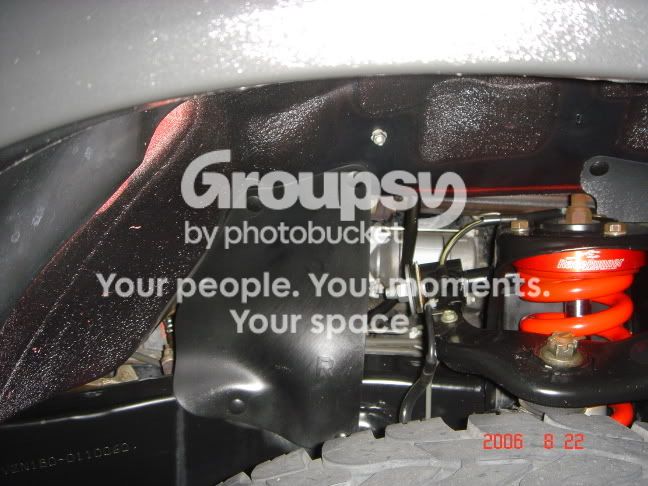

To clean the wheel wells, you need super hot water and enough force to clean up the gunk. Not my cup of tea for labor so went to a local spot and see how she came out:
DSC00815.jpg~original
DSC00816.jpg~original
