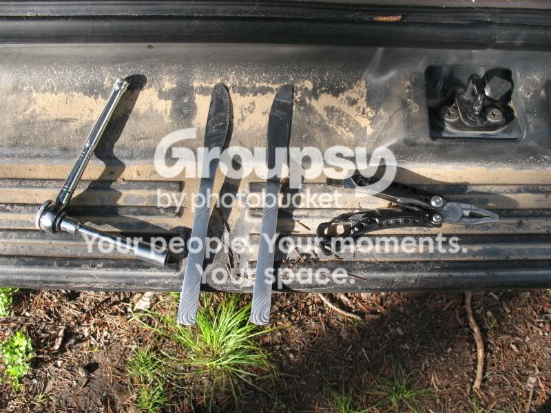

Tools on hand -

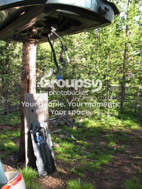

Panels off -

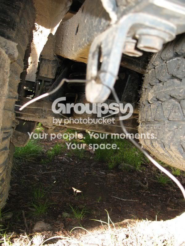

Tie wire to ground -

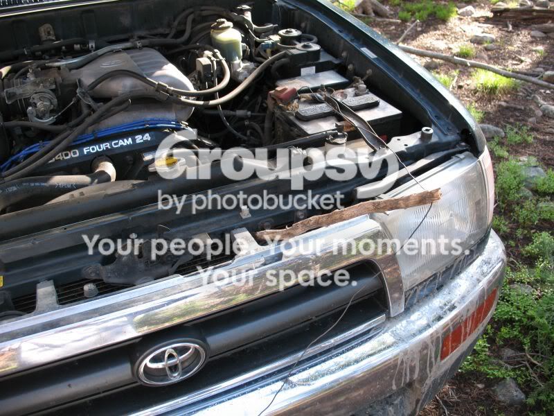

Tie wire to (+), check out the hands free device to keep it off the body!

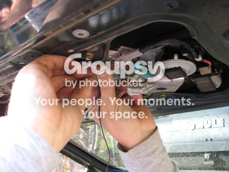

Two bare wires supply power to motor & up it goes!

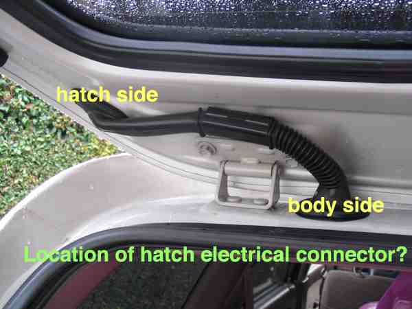

Take a look at the wire harness at the top of the rear hatch.(With it open) I saw another thread where the wires have gotten pinched/stretched and failed. See stock photo below.
