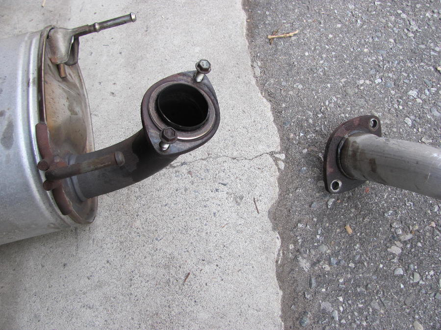

I asked about the cutting because Gibson's instructions recommend cutting the pipe after the muffler. I didn't know there was a flange there. I was under the impression it was all one piece. Good that Toyota put the bolts on top. It would've been too easy unbolting them from the bottom (the truck's new enough that, fortunately, I could unbolt the flange -- with a some blood and a lot of swearing).

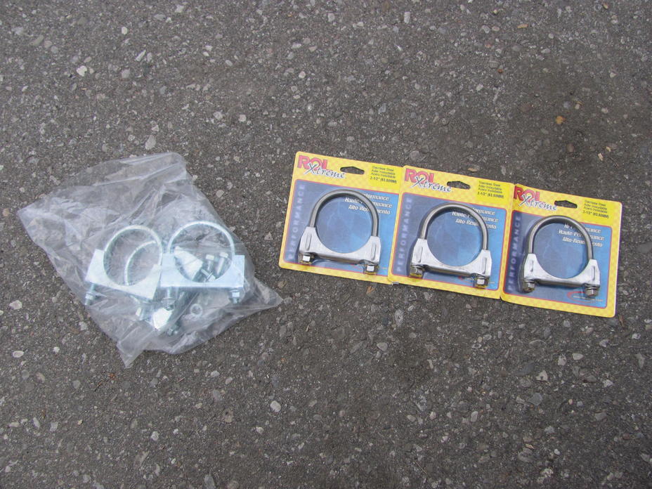

It went in okay with some fitting and adjusting but it's crummy Gibson doesn't include stainless steel hardware with its stainless steel exhaust. I spent an extra $40 on stainless clamps.
Also, another beef is that the metric flange bolts Gibson includes for the mid-pipe flare are too short for the Gibson flange and it's impossible to reuse the tension springs. So I left the springs off for now until I can get longer bolts. The bolts are a fine thread so I tightened them only enough to get a good seal -- reefing on them will bend the flanges, distort the flare or both which will screw them up for good and the joint will probably leak.

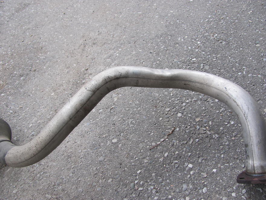

I'm not sure about the oversize 3" tip but maybe I'll get used to it. After the intial test run tonight, I'm pretty happy overall because it was the performance I'm after, not as much the sound or looks. Got rid of that pinch in the over-axle section as well. Maybe it's rose-coloured glasses but the L/100 km on the display dropped faster than it usually does and I was still flooring it plently. This is a good sign, especially now that regular is $1.35/L
