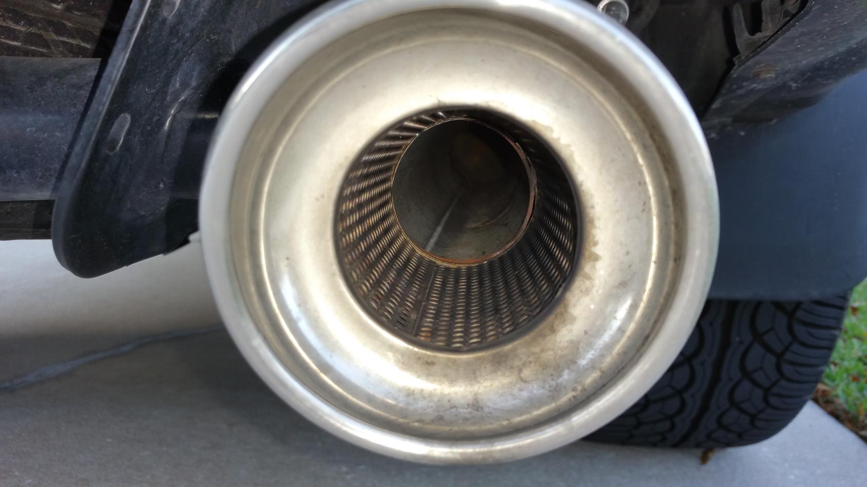

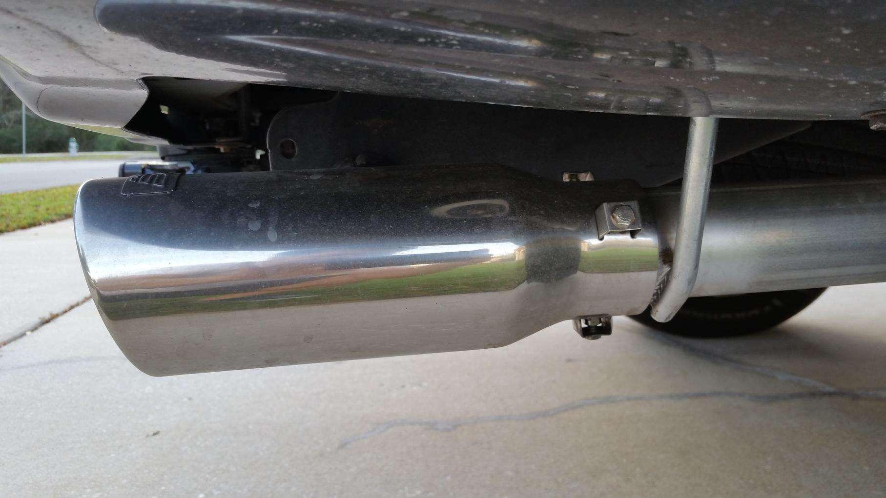

Sorry it doesn't work out for you. As a reminder: Did you cut part of the tail pipe?
Logically, if your pipe is through the resonator portion, it would circumvent the purpose.
The internal diameter of the resonator portion is smaller than the tail pipe, so it is not possible for the tail pipe to pass through resonator portion.
No! it not. Tail pipe will slide through resonator tip w/out any problems. Look at the pic I posted above.
